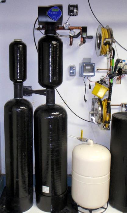

    Attachment 15371
    Here it is, installed and operational.
    Final equipment specifications:
    Stage 1: 10x22 with Garnet underbedding, 1/2 cu. ft. Turbidex. Reason, to eliminate the need for pre sediment filtration on my Reverse osmosis system. Turbidex filters down to 3-5 microns, more than adequate for any standard reverse osmosis.
    Stage 2: 14x47 with garnet underbedding, 2 cubic feet of softening resin, 10% crosslink. I also used a spider distributor for 14" tanks for better backwashing and distribution. I am not a fan of the spider distributors, but for this application I thought I would give them another try. I also slightly underfilled this tank since the backwash will slightly exceed the recommended 5 GPM per Sq. Ft. rating.
    Stage 3: 7x13 Garnet underbedding and 30# of KDF55, reason: Removal of heavy metals, and pre treatment of the GAC bed.
    Stage 4: 12x44 tank, garnet underbedding, 1.75 Cu. Ft. of CarbSorb. This GAC has been an amazing product, other than the difficulty in getting it to rinse down, this stuff is the nastiest, dirtiest carbon I have ever seen, it also works better than any we have tested.

    Thinking again after a Whataburger recharge. How are you figuring the tank diameter? The manufacturers seem to give a backwash rating of GPM as per cubic foot of resin? Are you using a cubic foot to mean a 12"x12" surface area or 144 square inches? Using the formula of pi times r squared to determine the surface area, a 10" diameter tank = 5" * 5" * 3.142 = 78.55 square inches. So 78.55" / 144" = 55% of the surface area. 55%* 15GPM = 8.25GPM.
    But then, does converting a cubic foot to surface area the correct way to figure this? It seems to me the only correct way to figure this is by contact time. You need the water in contact with the media a long enough time to let the media do its job. So now we would need to figure the flow rate of the water in a given amount of volume. I just don't understand how you would convert a 3D volume to a 2D area.
    Excellent observations for the backwash rates of the different media. This is more of an experiment on what can be done. I have adjusted all the tank diameters to "balance" tyhe backwash rates to their manufaturers recommended levels. The only one I am slightly off on is the water softener, I am slightly higher than the recommended 5 gpm per sq. ft. level, but I am also running a slightly higher than normal freeboard.
    The backwash rates are based on surafec areas.
    Micro-Z/turbidex requires 15 GPM per sq. ft, thus the 10" diameter tank 6-8 gpm
    Softeing resin requires 5 gpm per sq. ft, thus the 14" tank with a slightly lower resin level. 6 gpm
    KDF requires a 20-25 gpm per sq. ft backwash rate, thus the 7" tank. 6-7 gpm
    8x30 catalytic GAC requires a 8-10 GPM bsackwash rate, thus the 12 inch tank 6-8 gpm
    I will probalby use an 8 GPM flow control allowing the KDF to have the best possible chance of backwashing effectively. KDF only expands 10% at a 25 GPM per sq ft backwash rate. Most other medias have a 20-30% expansion rate You are definetly right about KDF being a pain.
    I feel KDF and Pyrolox are the 2 best modern medias available, they are also the two most difficult yo get to work right. They must be set up correctly to work as advertised and to last. The old blue system you see in the pictures above go for ten years and over 2 million gallons of water between KDF changeouts.
    The system will be designed with a downflow brine so excessive dilution of the brine will not occer going through just the Micr-Z tank. We regularly build units with a full 2 cubic feet of resin prior to the resin with no noticable or caculable changes in brine efficiency. If I move the softener tank to the end of the design which would be a more proper way to build this unit, I would definetly go upflow brining. Unfortunatel, I have been unable to come up with a good way to do that. The "off the shelf" tanks are not available with the proper openings.
    I really apreciate the input. It is helping me tremendously to find any bugs prior to building this unit.

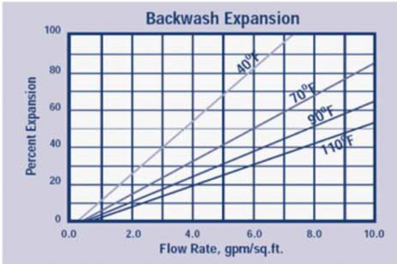

    Some great questions and comments. First off, the backwash rates of most medias is determined by area, not volume. We calculate the square footage of a given bed area to determine the correct backwash rates. Density of media, specific gravity, surface area, water temperature etc all must be considered, but for the most part, the manufacturers of the media give us some fairly easy guidelines to follow.
    Example,
    Standard resin should be backwashed with 30% expansion. This would require approximately 10 GPM per square foot. Notice the chart below, it gives the temperature / bed expansion information allowing installers to easily adjust the system to the proper rates for the water temperature. Many problems have been caused over the years by companies not considering water temperatures in their equations. One of the largest restaurant supply companies hired me as a consultant about 20 years ago due to the high failure rate of their equipment, it was simply a lack of temperature compensation for their equipment. In the end we save them 100X my consulting fees in the first year.
    As to volumetric calculations, we do that for some media, but not most. It is done typically to simplify the equations, but... surface area and bed depth are the preferred equations.
