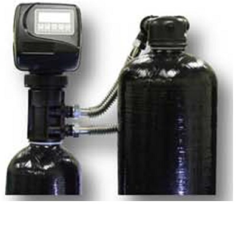

    This post is intended for the people in here that have extensive field knowledge. I am building a prototype to replace my last prototype system that has worked perfectly for many years. I design and test units regularly and once my testing is complete I usually reinstall the old design into a family members house. This new design is completely over the top. I am trying to build a single valve system with 4 different medias using off the shelf, non special ordered items. Most of my previous prototypes include a lot of hand machined parts. This design will have one hidden adapter that is not yet available, but shoud be in the fall. Here is the general design:
    1: Fleck 7000XTR
    2: 10x22 double open tank, 1/2 cu. ft. Turbidex or equivalent.
    3: 14x47 tank w/ 10% crosslink resin, 2 cubic feet
    4: 24 pounds of KDF-55 in a 7x18 tank
    5: Catalytic GAC, 2 cubic feet in a 12x47 tank
    The diagram below shows the water flow. All of my math calculations show a minimal pressure drop for a residential application and I should be able to maintain a peak flow rate of over 15 GPM. Sevice flow will be slightly less, but the truly functional medias at higher flow rates will be the softener and GAC tanks. The KDF is limited in its service rate but it will flow over 20 GPM in this configuration. Here is the question, for a municipal water application, other than being completely ridiculous, is there any major flaws in the design that you can see? I am hoping to have a system built and installed in a coupl of weeks. I am working on an article for publication in September and this system will be a small part of it if it works. One of my biggest concerns has been the frequeency of backwashing for the KDF, but this has proven to be a non issue in my old design which also includes a similar KDF tank backwashing approximately every 10-15 days. I have 20 of those units on the feild for testing and all have worked for many years without failure of the KDF.

    My concerns are that if the single valve head fails then all the units go down.

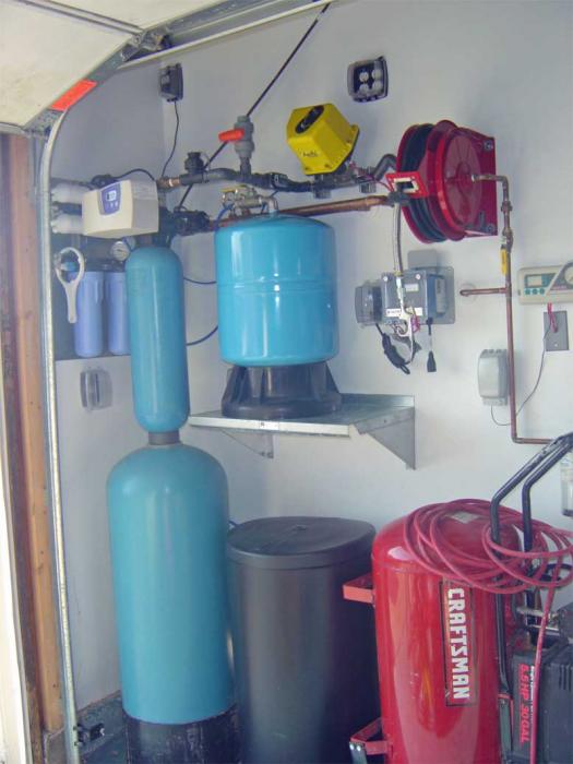

    My original design has the resin last, but that creates some problems with the lack of off the shelf parts to build it. my lat prototype is shown below, the tanks used for this system used to be reaidly available, the manufacturing has since moved to India and the cost and lead times make it prohibitive.

    I, too, like a thinking man and the wonder of initiating new designs as well as the fortitude to put it to the test. My major concern with this truly multiple-bed system is the wide variants in backwash flow rates enough to lift one media all-the-while not piston another media (carbon/resin) to the top of its respective tank. KDF, with all its wonderful attributes, doesn't do well in volumes; it is extremely heavy and tends to solidify in a short time if not completely lifted and expanded during back wash periods. I have tried lifting it in 6" tanks with 6 gpm and nothing more than a small geyser of media was elevated above the bed--the rest of the bed remained motionless.
    With the footprint your design currently occupies, two separate valves would prove more efficient and practical. In your design, would the brine solution go through all four tanks?

    I am curious about the adaptor that criss-crosses the tanks. where does that come from?

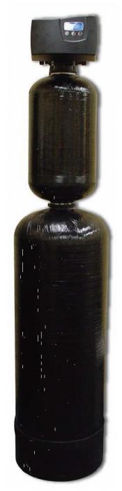

    We build a unit called the Enviro-twin but it is marketed under manu names by other companies. The flow is identical to the stacked systems. The limitation of stacked systems is a height issue. By putting the tanks next to eachother, you can greatly exceed the shared valve design. The marketing is the water savings, the fact that everytime the water softener regenerates, all the waste water is "resused" to clean the carbon tank for free. The real genius is in the money savings of only having to buy a single valve. This simplifies the system, saves water, and reduces cost while increasing marketing value.
    Kdf in traditional tanks can be done very easily but you are right in the expensive replacement costs. It requires a lot of waterto backwash. No less than 20 GPM per sq. ft, and preferably 25-30 to ensure many years of service. If you have enough water to backwash KDF, it can be easily used. In the past, the residential control valve, (5600, A155, Erie 541) could not backwash this media. The new generation of controls (Fleck 7000, WS1) can easily backwash it. It has opened up some exciting new markets for special applications where KDF really shines. Pre GAC treatment especially of Catalytic GAC's or applicaions where GAC should not be used IE: USP and WFI applications, GAC is avoided in engineering due to its high potential for bacterial and thus TOC problems.
    The adapter is by the company I work for. If you want detailed informatiuon on it, please send me a message and I can get you detailed information. I dont want to promote the company I work for if I can avoid it. We are an OEM distributor for water treatment systems. We primarily sell to large OEM's but we do sell to dealers as well. We do not sell to end users a all.

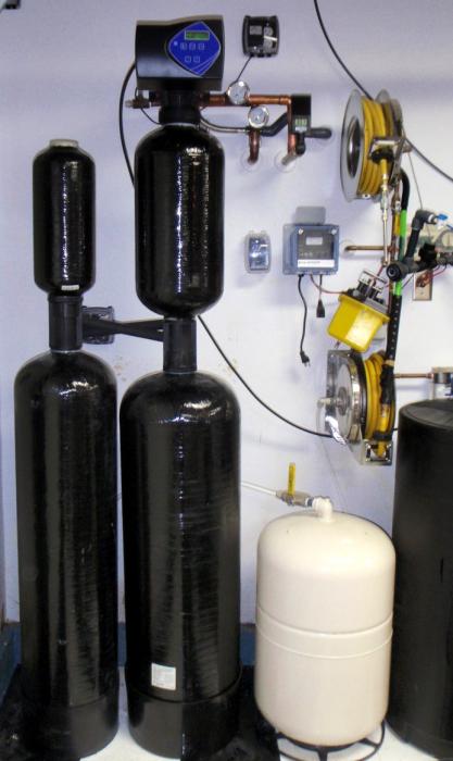

    Here it is, installed and operational.
    Final equipment specifications:
    Stage 1: 10x22 with Garnet underbedding, 1/2 cu. ft. Turbidex. Reason, to eliminate the need for pre sediment filtration on my Reverse osmosis system. Turbidex filters down to 3-5 microns, more than adequate for any standard reverse osmosis.
    Stage 2: 14x47 with garnet underbedding, 2 cubic feet of softening resin, 10% crosslink. I also used a spider distributor for 14" tanks for better backwashing and distribution. I am not a fan of the spider distributors, but for this application I thought I would give them another try. I also slightly underfilled this tank since the backwash will slightly exceed the recommended 5 GPM per Sq. Ft. rating.
    Stage 3: 7x13 Garnet underbedding and 30# of KDF55, reason: Removal of heavy metals, and pre treatment of the GAC bed.
    Stage 4: 12x44 tank, garnet underbedding, 1.75 Cu. Ft. of CarbSorb. This GAC has been an amazing product, other than the difficulty in getting it to rinse down, this stuff is the nastiest, dirtiest carbon I have ever seen, it also works better than any we have tested.
    So far, it is working great. Took me most of the day to build, install, rinse down, program, and clean up my mess. It looks a little odd, but so far it is working great. I am getting over 15 GPM through the tanks with 10 PSI pressure drop. I will play with this for a few days to see if it works as well as my calculations said it would. I will be putting a rotometer on the drain line to monitor it to confirm I am consistently getting 7 GPM to the drain.
