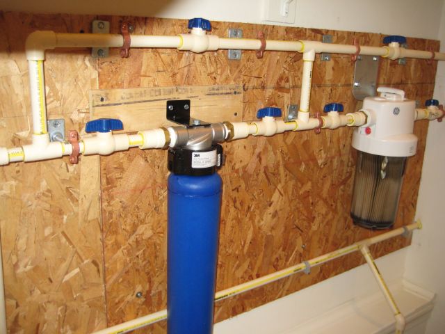

    I have a 3week old 66 gallon electric tank installed and at the time the guys didn't know there was a check valve in the whole house filter. I now need to install a expansion tank. I put a gauge on the bottom heater drain valve last night and it went to 115 lbs.The water heater has the cold inlet entering on the bottom and the top cold feed capped off of course.Would there be a problem with installing the expansion tank to the top of the heater in the capped off line?.I think it should work but would like opinions on this.

    This was a reply I got on another forum: " You can place an expansion tank anywhere between the check valve and WH". In my case the tank would not be between the check valve and heater if I used the top cold port...true, does this matter?
    19,223
    It will work where you indicate. The critical thing is you want it on the cold water side (heated water would degrade the diaphram quicker), and it needs to be in a place on the tank side of the checkvalve. Basically on either port of the heater designed for cold would work as it is totally open between the two. Not sure why you're using the low feed, but it should work...the upper one with the dip tube does as well, and it's often easier.

    The white GE filter on the right is the one with the built in unadvertised check valve causing the need for the expansion tank. The gauge pegged at 115 lbs on recovery.
