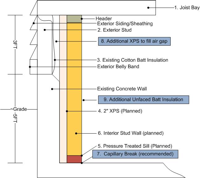

A lot to take in!
OK! Thanks for all that information, I've read it about 6 times now, and I'm hoping I'm getting the gist of it. I think you're what you're saying isn't too far off from my original plan.
For the record, I planned on using 2" XPS, but just to be absolutely sure, i took a page out of the building science book to make sure we're talking the same thing.
In the picture, all the boxed highlighted text is what I believe to be your recommendations, can you confirm:
7) A capillary break beneath the sill plate. In the past I've used 30# felt paper, is this still an option in this situation?
8) Additional XPS to fill gap between 2&3(exterior stud and insulation), and 4(planned 2" XPS). (I'm assuming when you said: "Where there's a pony wall with a step in at the sill or concrete, cobble-in rigid foam to even up the sill to the concrete so that you can fill the gap between the new studwall and the original studwall with fiber insulation without putting the insulation in contact with he concrete." this is what you meant?)
9) Additional Unfaced Batt insulation (possibly rockwool/fiberglass) within 6(the planned interior stud wall). (I also read your comment - "The value-proposition would be to use 1-2" of unfaced EPS (beadboard, like a cheap cooler or coffee cup) for R4-R8. Adding that to a 16" o.c. studwall with batts would come to ~R15 (1" EPS) to R19 (2" EPS) after the thermal bridging of the studs & plates are factored in" as an alternative to this, considering, also, your comment about not using cotton below grade...)
You gave me a lot of valuable info, I hope I understand it correctly, pictures always help me, so here goes >>
Thank You!

Unless the place marked "Additional XPS to fill air gap" is perfectly dimesionen for the XPS, there will be air gaps. I was recommending using compressed batts which are more compliant for any depth anomalies.
In the picture it looks like the top of the concrete is chamfered toward the sill rather than leaving a flat step, which could be reasonably filled with a chunk of 1.5" XPS to even it up level with the sill (which is what I was talking about with that verbiage.)
To safely stuff that chamfered corner at the top of the foundation with batts, put a capillary break between the concrete & batt to keep the batts from wicking up moisture out of the concrete. Cotton is VERY hygroscopic, and can pull a lot of water before it feels wet, but it's a mold hazard well before it gets to that level, and even fiberglass will pull water somewhat. A sculpted chunk of XPS or whatever would do the trick,or even a minimal strip of poly sheeting draped over the chamfer by an inch, stapled to the edge of the foundation sill.
Trimming and compressing batts in there for a reasonably tight fit will impede air motion in all directions, whereas less than perfect fitting rigid foam would leave thin flat air channels that allow lateral & vertical air flow, possibly even convection over/under the top. Foam can be an perfect air barrier if perfect, but is a lousy air-retarder if it has gaps that aren't spray-foam sealed on all edges.
EPS would allow better drying toward the interior than XPS, if you don't already have the material purchased. You need not worry about interior moisture drives wetting the concrete via diffusion through EPS, but unless there's a good sill gasket there's always concern about ground water/rain-splash/dew loading up the concrete just below the sill if drying toward the interior is impeded. At 2" XPS is less than 1 perm, which is moderately vapor-tight (a class-II vapor retarder), but at 2" most grades of unfaced EPS are 2+ perms, which is ~3x the drying capacity. EPS is usually cheaper too. Just avoid anything with a foil or plastic facer, some of which are under 0.1 perms, true vapor-barriers.
Yes, only unfaced batts would go in the studwall, but if there's even a remote possiblity of a flood overtopping the bottom plate of the studwall rock wool or fiberglass would be a better choice than cotton batts, since cotton will wick much higher up the wall, and and can't dry quickly- you'd have to gut the thing completely. With rapid-drying materials in the event of minor flooding you can cut the bottom 6-12" of gypsum to let it dry, then patch the gypsum once it's dry enough.
30# felt isn't bad for the capillary break under the studwall plate but rigid foam insulation is better, and gives it a bit of clearance in a spill or minor flooding situation.

Great!
Thanks for the reply!
I was taking some measurements tonight, and that chamfered edge isn't present in all circumstances, to be honest this whole house is just 'a little bit off' in every measurement and angle. So some places the sill sits flush on a flat concrete wall, in some places it's set back 1/2" from a chamfered edge, etc...etc...
I have some leftover batt material, so I'm hoping i have enough to do the first few walls to get a feel for it...just thinking out loud here, but I obviously need to make sure the batts cover the existing exterior studs toward the inside, or it will leave additional air space, correct?
I did order all the XPS, would it be advisable to not seal the sheets of XPS together with to get that interior dry potential? I had planned on sticking them together with the spray foam, that stuff is as good as any adhesive I've ever touched.
I also got some foam sill sealer and planned on using that under the PT sill plates, I will most likley double the sills so I can wedi/mud the floors per the other thread i got going here.
Anything there truly faulty in design?
Thanks again!

Yes, you want to trim and install the batts so that there are no voids, even if it's a bit compressed. If the batts can be split depth-wise to thin them out a bit it might be useful if the depth it needs to compress is too much. Compressing it an inch isn't too tough, but 2" might be awkward with high-density cotton batts. I've never installed them, you'd know better than me. I'm more of a blown-insulation advocate where fiber insulation is concerned, but on small projects like this it's not worth renting a blower if you can be obsessive about fitting the batts perfectly an not creating gaps or compression-voids.
You can and SHOULD seal the seams & edges of the XPS to make it a good air-barrier. Keeping it air-leaky barely affects it's drying potential, since most drying is via vapor permeation through the material. If air is allowed to convect all the way from the room air to the concrete there will be more wintertime moisture drive in that direction. (But in Seattle, that's not nearly as big an issue as it would be in colder climates.) Sealing them with 1-part can-foam is fine. Low expansion "Windows & Doors" variants will have less trimming to do. If you end up with a big blob of expanded protruding into the stud bay or compressed batt side it can cause a batt to bunch & move, creating a void, cutting into the performance of the batt.
The stackup looks good- go for it!
If you're going to finish the floor, now's the time to insulate the slab with at least R5 (1" XPS), but R7.5 (1.5" XPS) is still long-term cost effective in your climate, even if you're heating with cheap natural gas or heat pumps. If you're going to insulate the floor, extend the floor insulation all the way to the wall-foam as a continuous capillary & thermal break, resting the studwall plate atop the floor foam. The 1" version of Wedi is only ~R4, but there's no reason you can't put half-inch XPS sheathing or something under the Wedi to fatten up R value. More than R7.5-8 wouldn't make financial sense unless you're installing radiant floor (in which case you'd be looking at R10 as an absolute minimum) or if you're heating with resistance-electricity/oil/propane, or unless you're using reclaimed foam at a huge discount below retail. (If reclaimed roofing foam use EPS or XPS only- no iso. Some high-density fiberglass panels might cut it, others not.)
With the amount of insulation you're putting in the wall the losses through the floor are going to dominate the heat loss of that space at Seattle's subsoil temperatures. The compressive strength of even lighter duty 1.5lb XPS (Foamular 150, etc.) is more than enough to handle the studwall, which isn't structural- it's not holding up the house, just the insulation. Even low-density EPS can handle any of the loads you're talking about here, particularly with the load distributed by the denser-stiffer Wedi + mud flooring. (Low density EPS can be used under wooden subflooring too.)

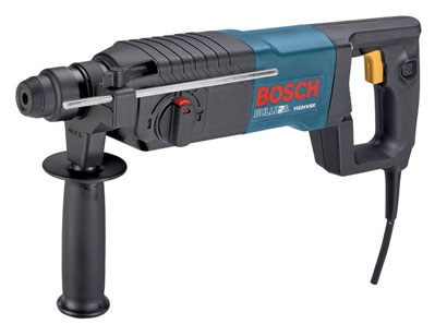

so is there a trick to the tapcon pre-drill? because the drill bit they gave me lasted about 5 holes and now it's completely useless, i can't drill any further than 1/2" into the concrete and the screws are 2 3/4", it's driving me crazy.

Are you using a hammerdrill/roto-hammer or did you try to burn your way through with a standard drill motor. The latter works OK on CMU/cinder block sometimes, but never on concrete or hard-brick.
A trip to the hardware store with the bit in hand you should be able to find a comparable carbide-tipped masonry drill. But you'd still need a hammer-drill.
32,771
1,191
A regular drill motor will overheat the bit. It is designed to act more like a chipper than a cutter. WIth a normal drill, it's trying to cut. Concrete is too hard for that, it needs to be chipped. WIth the right drill motor, it's not much different than drilling into hardwood.
