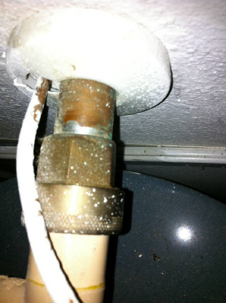

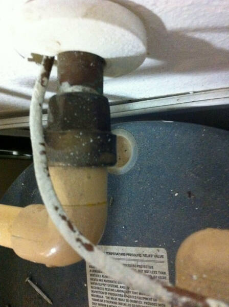

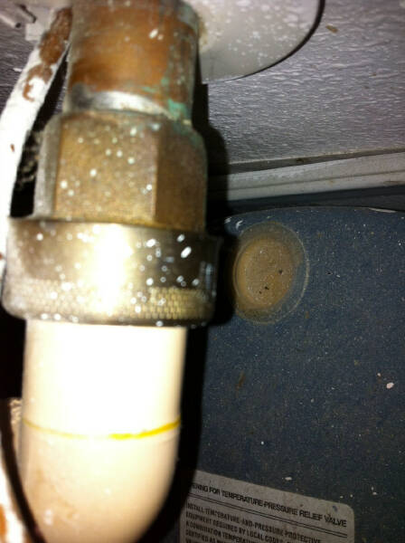

    I have good amount of experience sweating copper. I also have done a lot of PVC work with my irrigation system. I have no experience with mating copper to CPVC. I've replace several water heaters using copper only. Our vacation home has CPVC connected to the heater which I will be replacing shortly.
    Looking at the pictures you can see the adaptor is sweated onto the copper not very far from the wall. I do not want to put a torch to this as it is too close to the interior garage wallboard. Not being familiar with this adaptor I have several questions?
    Can someone tell me how the CPVC attached to this fitting?
    Is it threaded?
    Can it be reused?
    Is the CPVC 90d a special 90 to connect to the adaptor?
    I will be replacing the WH and before cutting out the CPVC I want to make sure I have what I need to complete the job.
    Jerry
    JR
    Jan 2008
    3,155
    It appears to be a copper to PVC transition union, which should unscrew.
    DIY Senior Member JerryR's Avatar
    Jul 2011
    Florida
    192
    So is it similar to one of these? I then should put an open end wrench on the flat to prevent the 3/4? copper from rotating and rotate the knurled ring counter clockwise with a pipe wrench?
    Jerry
    JR
    Jan 2008
    3,155
    Using a pipe wrench could distort the knurled fitting.
    I would give it all I had with my hand first (a glove might help).
    If I had to use a tool, my first choice would be a strap wrench.
