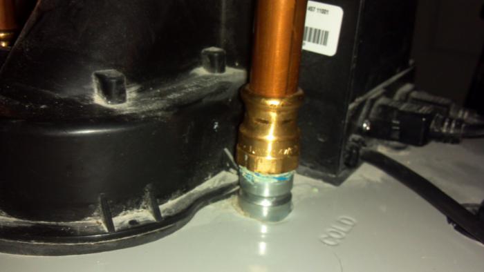

    Hi all,
    Recently, I flushed my hot water heater and I've been getting a lot of rusty hot water coming from the tap. It only comes from the hot side and not the cold and this is true of all the faucets in the house. (Last time I flushed it was back in may.) Now when I'm talking about rusty water, i see particles of rust shoot out of the faucet as well. I was curious and decided to drain the tank again, red-brown water came out of the garden hose drain. The odd part is, if I wait a week, I suppose the sediments settle at the bottom and I no longer get rusty hot water.
    Now this is a bradford white powervent 50 gallon that was installed 1.5 years ago. I contacted bradford white and they said I should contact a plumber to check the anode rod. I contacted the plumber who installed the water heater and he said he never heard of rusty hot water coming from the taps before. I didn't bother making an appointment because he said he was booked. Keep in mind I do get city water (which is half river water half well water) and I'm on a water softener.
    From what this sounds, is the lining cracked? If so, this is the 2nd bradford white in 7 years (water softener was installed 4 years ago.)
    EDIT: My house was built 7 years ago and has all copper lines. No galvanized anywhere.

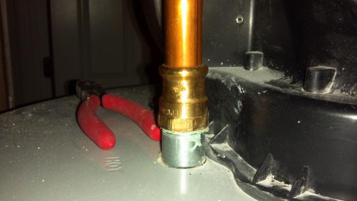

    The water pressure is about 70 psi. I do not have any check valve or prv. I did install an expansion tank a week ago (after I noticed the rust.) The T&P valve does open but it does reseal.
    here's the hot water inlet
    and here's the cold water inlet
    they don't look like steel. they look like copper?

    It looks like it transitions from galvanized steel at the tank to brass/bronze to copper, but the steel nipples on tanks are usually dielectric junctions (plastic lined) to prevent galvanic corrosion. On the cold connection appears to be a bit of blue/green copper oxides weeping out through the off-white pipe-dope on the exposed threads of the steel, which may indicates that the dielectric junction may be flawed, but it not necessarily. If you wanted to be sure you could break the connections there and install dielectric-junction unions on both the cold and hot sides, even though the corrosion seems more obvious on the cold side:
    [IMG]http://www.*******************/images/di-electric-fitting-fipsxswt.jpg[/IMG]
    Sacrificial anodes should be swapped every 6-7 years whether they need it or not, but water softeners shorten the life of the anodes and you may need a more aggressive schedule. If over-soften the water the anode could easily be toast in under a year. Softening the water reduces mineral deposits & grunge on the bottom of the tank, but it can also become a "solution-problem". I'm betting your anode is shot, despite being only 1.5 years old. If it is, drop in a new one (it's a sub-$50 part), back off on the softening agents and cross your fingers.

    The blue green stuff has always been there. I assumed it was some sort of threading to ensure a good seal.
    If the anode has already withered away, doesnt that mean the lining on of the tank is cracked then?
    I would service it myself but the problem is it's a bradford white and my copper lines are soldered in making it a PITA to replace the anode rod.

    It doesn't necessarily indicate a failed liner, but it might. Failed liners usually leak and rust out the side of the tank rather than make the water all rusty.
    Anode are usually screwout items from the top with a 1-1/16" bolt head. If it's rusted on pretty good you may need to use some sort of thread-penetrating solvent/oil and a half-inch breaker bar or impact wrench to get it started. It may or may not be covered with a plastic or metal cap on top of the HW heater. (I can't see it in either of your pictures, but it's there somewhere.) You can probably search out multiple you-tube vidis on how to swap out HW heater anodes with a variety of useful tips if you can't figure it out by poking around.

    As to the fittings the silver looking ones are heat traps and come installed from the factory,the copper fittings are propress and are NOT soldered. The rust issue may be a faulty tank, check your warrenty.

    I don't see any solder, I see pro-press.

    My question now is what exactly is pro-press and how tough would it be to remove the anode rod from the hot water inlet? All the youtube videos show a seperate anode rod hex nut, but none combined.
    21,405
    A pro-press connection is a special crimped connection...it is not soldered. There's an o-ring inside and a special tool compresses/crimps the fitting in place. Properly installed, I think the only way to remove one is to cut it off, then, your pipe ends up being too short. It might be possible to cut along the fitting and pry it off, but then it might mess up the pipe enough a soldered one or a new pro-press one may not seal easily.
