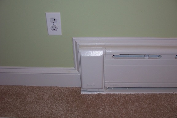

    Hi there just a quick question as to removing a cast iron baseboard radiator. I have cast iron baseboard heaters throughout my home including in my living room where i have radiators on 3 of the 4 walls which seems excessive as the room gets quite warm. I want to remove the cast iron radiator from one of the walls and put in a vent free gas fireplace there, mostly for aesthetics as I said the room gets quite warm as is. It would also give me the opportunity to lower the heat throughout the rest of the house and use the fireplace when the majority of time is going to be spent in the living room. As I am trying to save a little money as I am obviously going to have to pay someone to come in and install gas to the area, my question is this, how do i remove the radiator. I assume I am basically going to shut the system off and bleed it and then cut the pipe going into the radiator and the return at the other end, remove the radiator, and then couple the two pipes i have just cut down in the basement so the system is complete again? Does that sound about right. Also how is the radiator fastened to the wall, i assume there have got to be screws fastening it to the wall. My radiators look like this one i found depicted elsewhere on the website.
    Also as far as the radiator goes, from looking around on the internet I see cast iron baseboard radiators are quite pricey, should I store the radiator in case something happens to other radiators in the house, it's an 8ft section? Or just junk it/give it away? Any help would be much appreciated. Thanks
    23,518
    You do connect the two lines back together. It is held to the wall with a screw through the small square metal piece in the slot of the radiator. It is probably four 2' pieces rather than one 8' one, so save it for possible repairs someday.

    So i simply cap the return and the input pipes?
    Aug 2009
    South*East
    1,005
    If it's a one pipe or two pipe system they can be caped. If it's a loop system (which I doubt) they must be tied back together.
