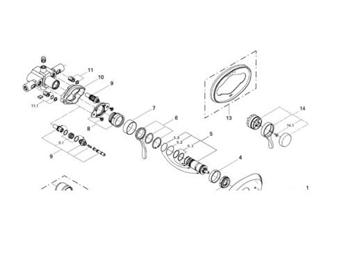

    Default Same problem - I called Grohe
    Wow.
    I am having this exact same problem. The 34436 was installed in May of 1997. When the lever is turned all the way to the left the tub spout leaks. My assesment was the same, I concluded it was the stop valves. I tried to find the right sized o-rings, but to no avail.
    I ended up calling Grohe parts (630) 582-7711 and asked for technical assistance. They agreed that it was the stop valves (part no. 08.355) and I asked if I could replace just plunger in the stop valves. They said no, but there is a washer set that I can use to replace all of those washers and o-rings. THe part number for that is 47.045, and it lists for $26.00. It has the o-rings for the hot and cold sides and the replacement screens for the stop valves.
    I am curretly looking for local distributors so I can buy one on the way home from work.
    Per the Grohe technician's advice I plan to replace the rings on the plunger and lube them. I may replace all of the o-rings that are available in the set. I have seen no evidence of pitting or corrosion in the valves, so I am thinking it is just the rings.
    So far Grohe's assistance has been very helpful for me.

    Default Results
    Well, I purchased The Grohe replacement washer set (part number 47.045) from a local Grohe dealer. I replaced all three o-rings on the plunger in the stop valve on both sides. I also replaced an o-ring in the outside of the stop valve (the part that holds the screen) on the hot and cold sides. The leaking stopped.
    The replacement washer set contains far more washers than I needed for this job, but that is OK. I hope I never need the remaining washers to replace o-rings in the thermoelement.
    I was happy to replace the middle washer on the valve stop plunger and the washer by the screen, as both were pretty well flattened, and one fell apart as I tried to remove it.
    The washer replacement kit came with a small amount of Grohe's lubricant, which I applied before re-assembling the stop valve, Things went back together pretty easily.
    SO, overall Grohe support and thier local dealer helped me get a solution to this problem. I think there is another washer set available that replaces just the two washers on the stop valve assembly (near the screen). This washer set may have done the trick as well. I do not have that part number in front of me, but it consists of a total of 4 washers, two for each side.

    Default Groche 34436 (weak water flow)
    I bump into this thread while researching how to trouble shoot a recently developed weak water flow from a grohe 34436 valve. I have eleminated any blockage in the hand shower head and flex host. One noticable symptom is that adjusting temperature may result in a temporary increase in water flow.
    User "lambtron"'s 10-05-2006 posting referenced a stop valve filter. Where is such filter located?
    Currently, I have disassemble sufficient parts to expose the frontal wax cartridge, and shut off the hot/cold service stops.
    What is a safe way to take out the wax cartridge?
    Below are the URLs to the valve schematics and part list:
    http://db.grohecatalog.com/upload/p_explo/E34436US.jpg
    http://db.grohecatalog.com/upload/p_spare/sp34436.gif
    Thanks in advance.

    After some tinkering, I was able to access the stop valve, and find that the
    filter is a piece of wire mesh wrapped around the middle of the valve stem.
    The filter is cloaked with debris. After cleaning the filter and flushing the
    valve, the water flow is backed to normal.
    The comments in this forum has been extremely helpful.
    Thanks again.

    Thanks to this forum for giving me enough information to start my repairs. My eight year old Grohe shower valve 34-436 was dripping. I could not find the O-ring repair kit mentioned above at any dealer or even the Connecticut Grohe distributor. However, two of the three I talked to said that the solution was replacement of the complete stop valve assembly, not the O-rings. The other did not offer a comment. It seems the cost of the assembly is $160 (not sure if that’s for a pair or not). I e-mailed Grohe tech service (see http://www.groheamerica.com/s/25_406...contactus2.htm) and asked if O-rings only would do the job. They said I should replace the whole stop valve assembly and sent a pair to me under warranty. P/N 08 355 00M. My experience follows. Do it at your own risk. I suggest that you get the valve assemblies from Grohe and then use a plumber if you have any trepidation.
    Make sure you mark each part as to the order removed and which side faces forward. Use the diagrams at the locations listed below to help you:
    You will need a 17 mm socket to remove the stop valve assembly. Since the stop valves are spring loaded and push into the assembly, it does not have to be a deep socket.
    Replacement is a little tricky because the whole volume control assembly (including the stop valves and yoke) wants to push outwards until the retaining ring that holds the volume lever is replaced. When the assembly moves out too far, water squirts out of the holes as mentioned in a previous post. Since you have to turn on the service stops before replacing the escutcheon, volume control lever and retaining ring, it becomes impossible unless you shut off the water to the bathroom first.
    The squirting water is a normal consequence of the stop valve design and is usually prevented from happening by an O-ring internal to the valve. When the valve is pushed out too far, the O-ring becomes useless and hence the squirt of water. This will not happen with the volume control lever retaining ring in place unless the yoke plate attached to the stop valves is not adjusted properly (perhaps this is the problem observed in the previous post). I suspect that the hole is there to relieve air pressure internal to the stop valve as the yoke pulls it in and out. However, if the O-ring should fail, it will be a heck of a mess that you won’t detect until the walls or ceiling show signs of water damage. I hope I’m wrong about this observation, but I don’t think so.
    You must adjust the yoke assembly before replacing the escutcheon. This means you first have to put the yoke, volume control lever and retaining ring in place without the escutcheon and adjust the yoke position by turning the white Teflon ring (using the volume handle) counter clockwise until it stops. This is the off position. Mark the position of the white ring at that point. Then disassemble and reassemble with the escutcheon in place and positioning your mark properly. Don’t forget to turn the service stops on. Turn the bathroom supply on after assembly.

    Perhaps someone can help to diagnose my problems with a 1-year old Grohe 34-436 unit (at this stage I must admit that it’s had the problems since it was installed – it’s taken me until now to try and solve them , prompted by finding this thread and realizing that others have problems with this unit as well…!):
    1) Although the input water supply temperatures are 72 and 122, the full range (from full cold to full hot – past the stop) from the valve is only 96 to 104 degrees.
    2) The water flow is relatively weak, and the water only comes on after the lever is moved past the half way point.
    I have stripped the unit and cleaned the filters (didn’t have much gunk on them) and with the stop valves and element removed flushed the system (and this showed that the supply pressure was ‘good’ although I don’t know how to measure it more precisely).
    And a reassembly question – do the stop valves tighten onto the black plastic escutcheon attachment collar, or do they tighten directly onto the brass body?
    I used the Grohe ‘contact us’ system to seek their suggestions but didn’t get a response. Any ideas out there…???
  13. #28
    Apr 2007
    Ontario, Canada
    877
    If you get differing tempertures i would say it was the cartridge, but if your getting low flow i would say there is a blockage.
    The stops and valves thread directly into the body.
    On the unit there is two stops and two stop valves with strainers have you checked all of them?

    At least part of the problem was that the installers (all 4 of them puzzled over how to install this fitting) screwed the inner stop valves onto the rim of the black plastic escutcheon attachment collar rather than directly onto the brass body of the fitting - that restricted the amount of inner stop valve movement. Last night I quickly fixed this and there is now much greater temperature variation and slightly greater water pressure from the shower head (a Relexa Ultra - perhaps this isn't a great shower head for strong water flow?).
    I haven't yet stripped out the outer stops - I was using them to shut off the supply and didn't realize that they have filter screens as well; I'll do that in the weekend.
