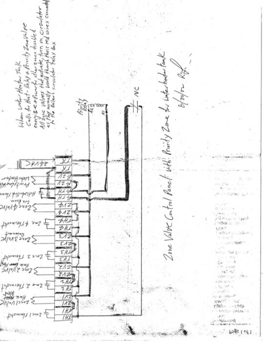

    I'll scan in my sketched w/d and post it here.

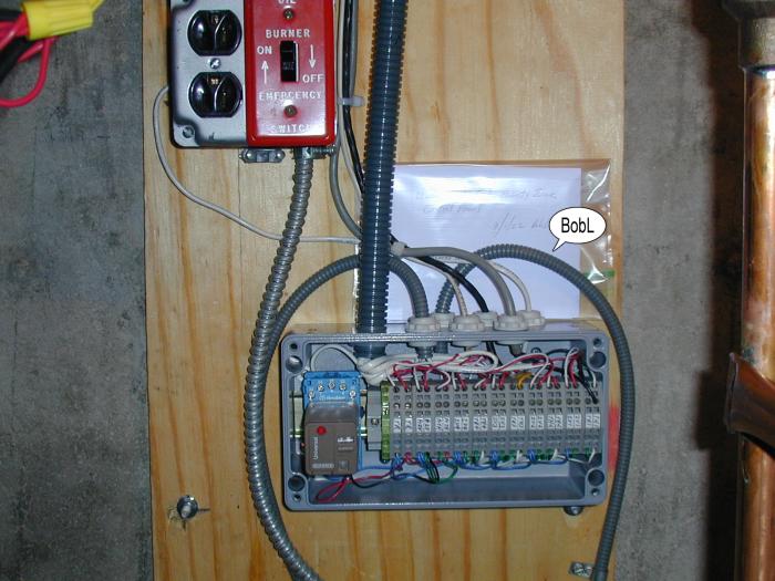

    Name:  Zone Control Box004.jpg
Size:  49.1 KBName:  DSCN0967a.jpg
Size:  61.6 KBAttachment 15035
    Quote Originally Posted by BobL43 View Post
    Here is the w/d and a photo of the one I built in 2002 . what is not shown here are the 5 zone lamps for the front panel that show when each zone valve is energized
    Looks good. I had to tip my lap top up on its side to read the w/d. Good thing I don't have an I Pad.
    Seeing that makes me want to build my own, but time is an issue. Not that I mind taking the time but my wife gets envious if I give a project more attention than her.
    I do have a whole stack of 24V ice cube relays that a crying out for a higher purpose than collecting dust. Hmmmm.... now I just have to come up with an explanation how this will save us money.
    What did you use for the zone lamps?
