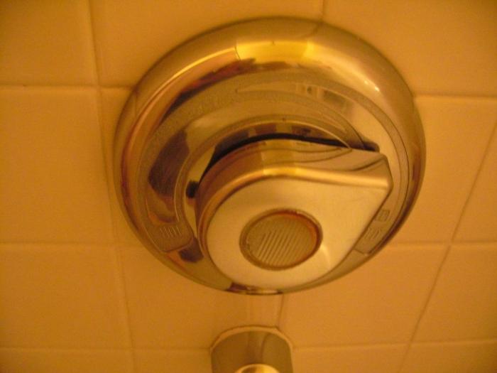

    House is about 13 years old. My shower's mixing valve, (trim ring stamped "sterling") is either all hot or all cold when turned on (i.e. no longer mixes the hot and cold correctly)
    Is this an overhaul or a complete valve replacement?
    Thanks a bunch!
    Dec 2007
    7,460
    Can you post a picture of it.
    Probably a little rebuild will have it working like new...

    Do you need a picture of the actual valve, or will an exterior picture with the trim parts installed suffice?
    Dec 2007
    7,460
    An exterior picture may suffice.
    I just want to ID the valve hopefully get you info on it.

    Sorry took so long. Here is the pic. Thanks!

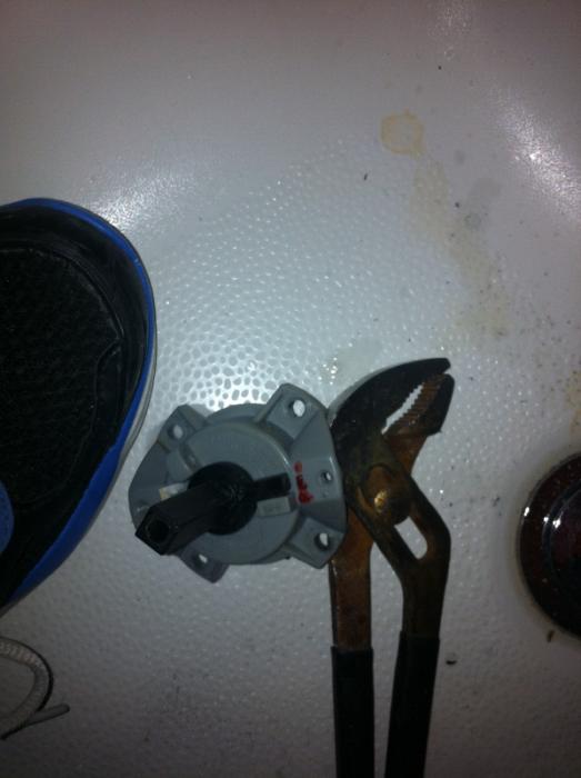

    DIY Junior Member kwspears's Avatar
    Dec 2011
    Chesapeake, Virginia
    I have similar setup in both my shower units. Can't get water fully hot, or worse, every once in a while a blast of scalding hot water comes through. I have replaced the mixing valve with a new one, but still haven't fully fixed the problem.Name:  IMG_1382 (598x800).jpg
Size:  32.5 KB Not sure if there's something I can do to the mixing tank (I think that's what it is) behind the valve or if I have to do replace it. Any help you could provide would be helpful.
    9,003
    The outer stem, and the inner balancing spool, are readily available at a plumbing store ( not usually at any of the hardware stores.). NOT necessary to open the wall and change the valve body.
