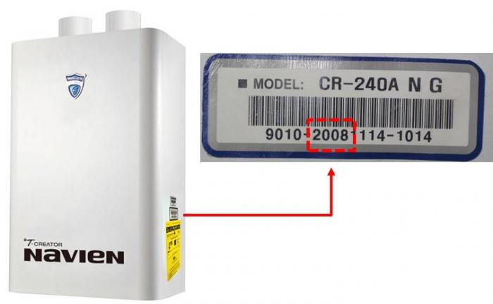

Navien recall
Jimbo
8,918
San Diego, CA
http://www.cpsc.gov/cpscpub/prerel/prhtml12/12074.html
Description: Navien tankless hot water heaters are white with “T-Creator” and “NAVIEN” on the front. Recalled model numbers are CR-180(A), CR-210(A), CR-240(A), CC-180(A), CC-210(A) and CC-240(A) manufactured in 2008. A label on the side of the water heater lists the model number along with the manufacturing year in YYYY format.
