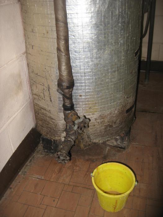

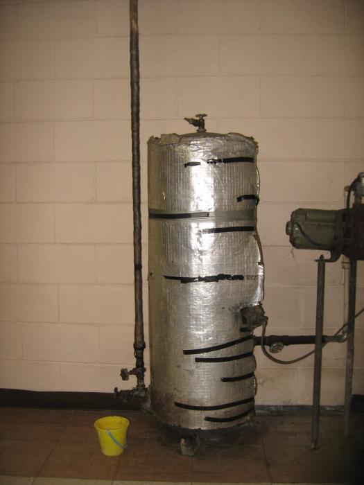

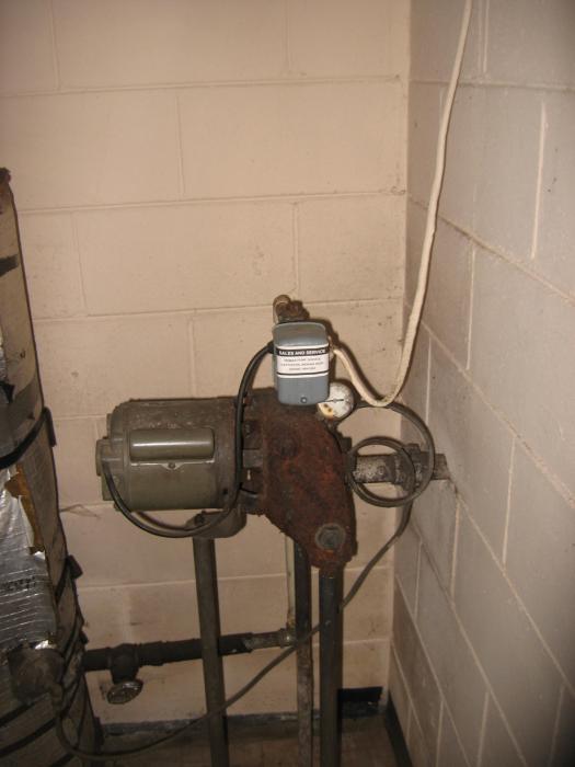

    Attached are pictures of a well system I am inheriting with a house I am buying in Indianapolis, IN. It is the original system from when the house was built in 1956, bladderless tank and well pump (Duro 3.5 GPM). The well is thought to be not very deep. I know that I should go on city water but financially now it is not good for me to do. The switch on the pump does not work all the time. What upgrades do you suggest?Name:  IMG_4328.jpg

    A new switch would probably run you around $20.

    If thats original 1956, then you got a charm. Wait till it breaks and then replace it with parts that will last about 8 years today.
    Porky Cutter,MGWC Porky's Avatar
    Jan 2008
    Virginia Beach, VA
    686

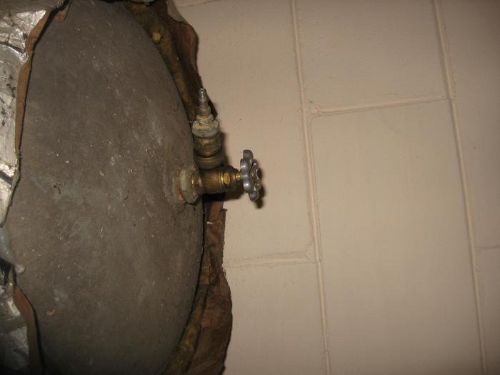

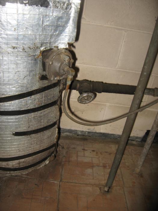

    That is an old system! But if it works what the Hey! The Schrader (tire) valve on the is to ocassionally add air to the tank if it becomes water logged. To add air you will need to turn off the power to the pump. Then drain the tank down at the lower faucet on the bottom of the tank, while adding air to the top until you get air from the bottom tank faucet. Then close all faucets and turn the pump on. The pump will probably run a while while filling the tank. If the pump loses prime I suspect that the diaphram in the air volume control has a leak. Replace the AVC or just plug the small line that goes from the tank to the pump. When it works it's supposed to inject a little air in the tank each time the pump starts.
