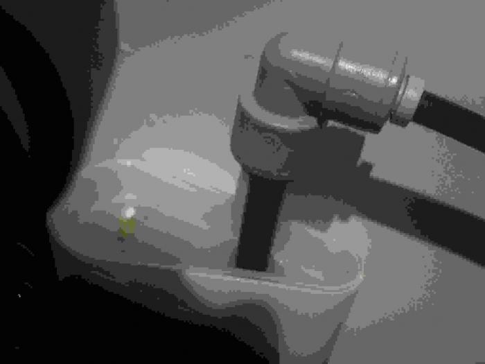

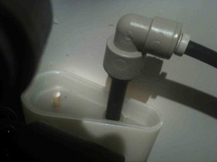

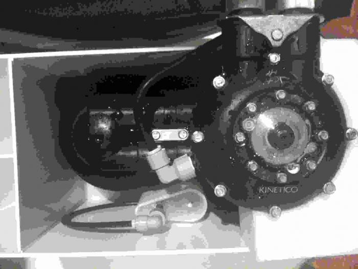

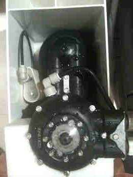

I have a Kinetico softener, which I had new 10 years ago. Like everyone on this forum I can't locate any info on troubleshooting problems. Also I can't relate my model to any US/Canadian models - I can't find any model number on the system. Mine is twin cylinder, see picture and the cylinders sit in the brine, all enclosed in a single tank. I use 2 block salt refills, each block is about 8.8 lb in weight. They stand on an open fret to ensure only the bottom edge of the blocks are in the water/brine
I have a problem whereby the system regenerates correctly on one cylinder, i.e. ‘Brine – Rinse’ & ‘backwash’, which finishes by providing about 3/8th inch depth of water to interface with the bottom edge of the block salt. However, when the other cylinder is in regeneration, ‘Brine – Rinse’ is OK but at the end of backwash the water can be heard to be continually running, I think to drain and the 3/8th inch depth of water to interface with the bottom edge of the block salt is not supplied.
So it is working one side but not the other!!
My assumption is that I will need to get into the mechanism on top of the main cylinder and investigate what is malfunctioning??
Has anyone got info on which ring of bolts I open first, the inner or outer first or all of them - is there a set order of undoing has anyone ant pictures or info please?

That unit corresponds to the US version 2020 (with 6" tanks). There are a couple a versions of the 2020. Disassembling the valve is quite easy with just a few things to keep in mind. Never use any petroleum products for lubrication or sealing. Let me know if you get the diagrams.
Running to the drains may be caused by a few problems including quad-rings o-rings that have suffered from chlorinated water, quad-rings may be rolled, pinched, dirty or cracked, lose in incoming water pressure, foreign matter preventing a piston from shutting, balance piston not seating properly, scored control disc, etc. Most of these can be remedied easily. A scored disc, which is not common, would require replacement.
Do you have a pre-filter to eliminate chlorine and/or catch sediment?
