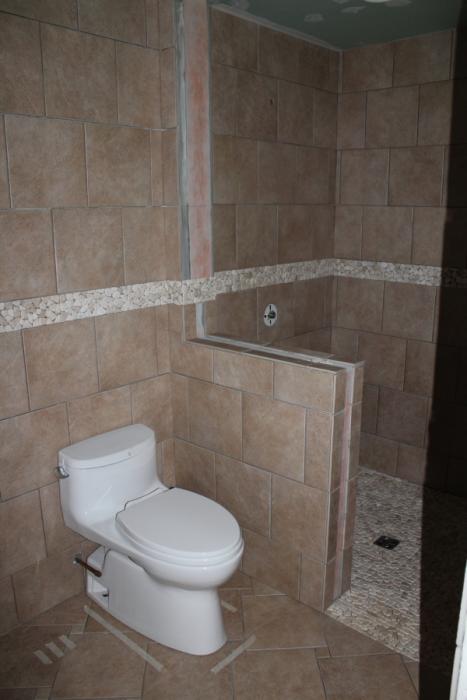

    Default Thanks for the help - you guys were right on the money.
    I purchased and installed the Carolina II with the standard (included) 12" rough in Unifit adapter. Since there is a bit of adjustment, it fits perfectly with a 11.5" center of the flange to the back of the wall measurement. Just like Terry said, 1/4" from the back of the tank to the wall!
    Many thanks for your help gentlemen.
    Now, what is the best way to set the toilet solidly on the floor? Should I be using plaster of paris, or is there something else I should use to make a nice solid mount? Thanks again!

    If the bowl has movement on the tile, and needs shimming, then shim from the back, forcing the front of the bowl to the floor.
    Make sure the bolts in back are loose first, then shim, then snug the nuts down. After that, take some clear polyseamseal and caulk the bowl to the floor. With the Polyseamseal, you will be able to pull the bowl if it's ever needed.
    DIY Junior Member captain pat's Avatar
    Dec 2011
    Hawaii
    Thanks Terry. Is it OK to use a silicone based caulking compound? It's made by the grout company to match the grout, and is used where walls and floors meet. Same exact color as the grout.
    14,202
    Silicone based?
    That should be fine. Some use pure silicone, but it's a bear to pull up if it's ever needed.
    We like to use clear, so it doesn't show on the white porcelain. But there are also arguments for using color matched too.
