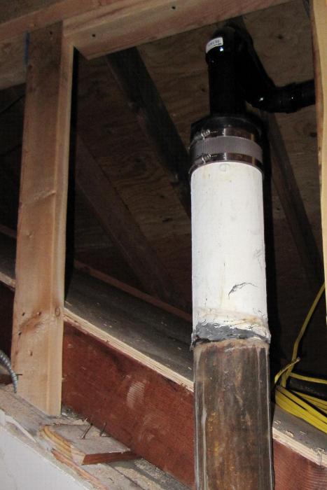

    is this OK?

    No. There is a reason vents are the size they are. Your plumber reducing vent lines like this and your other post is not something they should be doing, or any inspector should be approving.

    I guessed so by now... what are my options? Ask the inspector to come back and have a closer look?

    Is that the only vent in the home? IPC calls for one vent that is half the size of the building drain which in most cases is going to be 1 1/2" to vent through the roof so it may well be to code.

    this the vent from the main stack (which is 4 inches) and it is suppose to combine with other vents (from individual fixtures) in the attic so one vent will go through the roof.
    My concern is whether the vent can be reduced in size on its way upas shown on the picture?
    Huh? 1.5" isn't enough to vent even 1 toilet. Pretty sure you need at least an equal total area of venting as drainage, so for a 4" stack, you need a 4" vent, or a 3" and a 2" (I think, not looking at the equivalents right now), or some other combination. Also, I don't think you're allowed to reduce a vent like that... maybe if the total venting load on the line is less than the allowable fixture units for a 1.5" vent, but again, that wouldn't even allow there to be a toilet on this line.

    I have two stacks in the basement. One was (and will be when the addition is done) serving toilets and all bathrooms (2.5) and this is the stack vent on the picture (i.e. the one that was reduced by the plumber to 1.5, maybe 2 I had not measured). My understanding of the code was that the vent size cannot be reduced, hence posting this picture and asking plumbers who know the code for clarification.

    WE do NOT know how your code is written. In your area it may state that you need a ""full size pipe from the sewer connection out through the roof. Or it may say that the "total" AREA, (not diameters), of the vents through the roof must equal the area, (NOT THE DIAMETER), of the incoming pipe, but from the appearance of that vent it conforms to NEITHER requirement. In fact, in many "freezing" areas, the pipe, regardless of its size has to be INCREASED one pipe size, (but a minimum of 4" pipe), from 12" below the roof to its temination above the roof. If you were in Chicago or Arizona, I could tell you which rule applies.

    There is no way, in any part of the country, that what you have described is legal. Your plumber and inspector are both doing you a huge disservice.
    Find a highly reputable plumber in the area and have them come do a full inspection of this. From what I've seen so far, there are probably far more errors, or at best lots of bad practice stuff (like all those fittings on your water supply lines).
    You absolutely cannot have the stack just cut off in the attic... it will need to be taken back through the roof, or taken over and tied in with the main stack vent. This vent will likely need to be 3" or 4" through the roof, depending on your local code. We get decent snow here in Pittsburgh, and are allowed 3" if the stack is 3". If its 4" stack, we'd require either a 4" through roof, or a 3" and a 2", or some other combination, as jimbo said, to get the same area venting as the total drain stack capacity. If you have 2 stacks, you will almost certainly need 4" if they let you go through roof with just 1 vent.
    The 1.5" or 2" reduction is a joke.

    If your code is the IPC you need to read section 9. You only need one vent that is half the size of the building drain through the roof and furthermore the distance from water closet to vent is listed as "unlimited" with no size requirement. And BTW technically toilets do not need to be vented as they are a full siphoning, self vented fixture.
