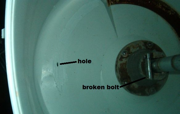

    My wife found the head of a bolt in the drum of our washing machine a couple of days ago, and today I found its origin. The bolt-head had broken off from the hub holding the washer's drum to the center spindle, and that had allowed the drum to spin out-of-true and rub a hole in the outer tub.
    How would you repair this hole? The tub appears to be PVC. I have welded PVC with heat and a filler rod in the past, but that would be difficult to do down inside this tub, and I do not plan on pulling the tub from the machine in order to be able to turn it over.
    I mentioned epoxy to a local appliance repairman, but then he mentioned JB Weld (trademarked).
    What might anyone here have to suggest?

    I think JBW is just an epoxy. If replacing the broken bolt has the cause of the problem cured, and the only remaining problem is to seal the hole, I would give the epoxy a shot.

    Do you have enough clearance between the "dry" side of the tub and the "innards" of the washing machine to insert a very short stainless steel or plastic carriage or flush head screw or bolt into the hole? Or maybe insert a short bolt into the tub from the "dry" side and cap it with a cover to limit clothes tangling and finger smashing? If this would work and you used a heavy duty sealant it may be better than just epoxy, etc.

    It is hard to get any Glue to stick strong to that type of Polymer.
    JB WaterWeldŽ may be worth a try as it can be formed and can fill a hole better than plain epoxy.
    It is also made to be under water.
    You would have better luck if you could put it on both sides, and cover a large area for better adhesion. (Rough it up with sandpaper before hand)
    It looks like a good size area is very thin near that whole.
    I will be off to the hardware store this morning, and I have been thinking the same kind of thing ... possibly an elevator bolt with an o-ring under its head, and then epoxy to help assure a tight seal. I suspect there is about 1/2" clearance between the fixed drum and the rotatable tub, and that clearance should remain consistent after I replace the broken hub bolt that had allowed the drum to run like a tilt-a-whirl ... but then whatever repair I make must still be able to stand against a hard uni-directional flow of water every time the drum spins.

    I was afraid of that! I will do a bit of testing to see what might stick best, and I might try some of this 3M 5200: http://www.3m.com/product/informatio...e-Sealant.html
    Quote Originally Posted by DonL View Post
    What you actually see there is material from the bottom of the drum, and then the hole appeared in the tub after the friction-welded spot broke apart. Since the drum has a thicker wall than the tub, the more-flexible tub lost no material in the incident (other than right at the hole).

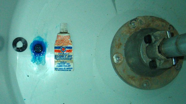

    Here is where we ended up on this one. The closest I could get to an elevator bolt came from some bolts for flat-pack furniture. I had thought about a toilet-tank bolt and washer, but shied away from their overall height. The excess part of the thin faucet washer I used seems to indicate there is still some rubber under the bolt's head, and I carefully selected this particular "Gasket Dressing And Flange Sealant" after discovering all my others were too old to use anyway. To hopefully keep all of this from happening again, I replaced both hub bolts with some grade-8s and found the loosest spot on the spindle where the hub will be least-likely to slip.
    I will let you all know if I begin seeing blue specks in my underwear ...
