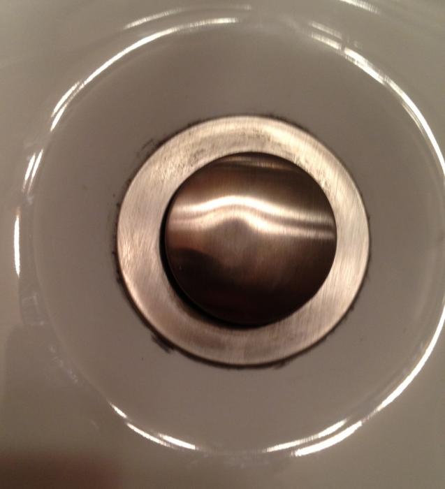

    Hi,
    I installed a new pop up assembly (Peerless) in this sink, and made a bit of a mess of it, I guess by not getting the excess silicone all cleaned off quickly enough. Still, I figured I would be able to get it removed, got to be a fairly common problem, I would think. But this stuff just doesn't seem to want to come off... that spot at the 7 o'clock position especially. I suppose the best route is to disassemble, scrub it, and redo, being a little more careful. But I'm concerned I still won't be able to get those marks off. I am wondering if there is something I could clean it with that would get it off? Lacking that, it is possible to find a slightly larger flange that I could replace the current one with to cover up any discoloring I can't get off? Thanks!

    Try something like a sharpened (chisel-ended) popsickle stick so you can scrape hard without damaging the surface of the sink.

    Plumbers putty is what should have been used there. Common methods of removal are mechanically scraping such as with a razor but there are chemical removals on the market.

    Try alcohol, but it may not work now that the silicone has set. That is one of the the reasons few plumbers use silicone.

    There are some well-known colleagues on the internet that use silicone exclusively. In my experience, the secret with silicone is cleanup before it sets. You need to treat it just like you do dap.....smoothing the bead if there is one, and totally wiping the excess. The caveat is that of course you can't do this with a wet finger or damp rag. You must use solvent. Two that work well are denatured alcohol ( not rubbing alcohol ) and mineral spirits.
    For your situation, you should be able to carefully scrape with something very sharp. That can be a carefully split popsicle stick, a new plastic putty knife, or even a sinlge edge razor blade. Held at a low angle, that will not damage the porcelain.

    I dissembled the popup to better get at the staining. Tried razor blade, Goof-Off, etc. but nothing worked. Then I tried a pumice "scour stick" and it worked great... took a little elbow grease but it's all nice and clean now. Going to use putty when I reassemble...
