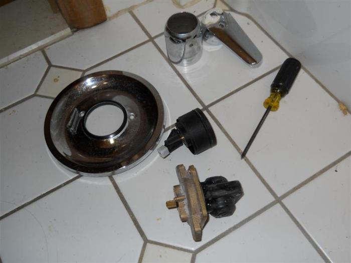

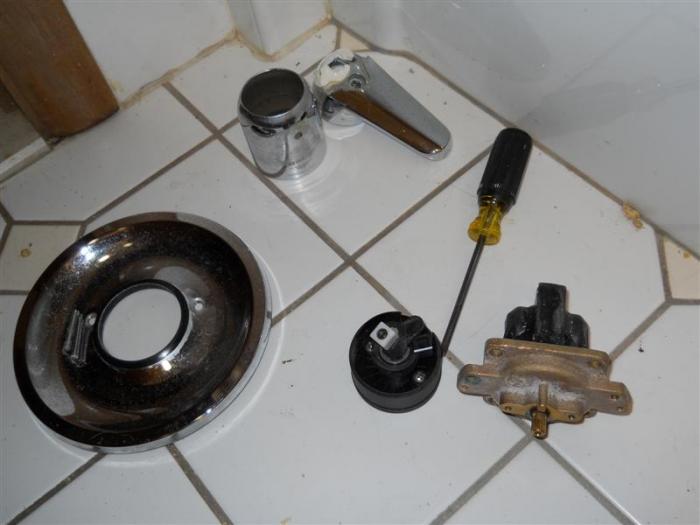

    Default Wrong part ID'd by Grohe,do you recognize this part?
    Progress, sort of. I ordered the part identified by Grohe (cartridge part # 46-0848, pictured above), and then took the shower apart to make the replacement. Lo and behold, the innards don't look anything like what Grohe told me to buy. Lesson learned, dismantle it, then take the part to the store and buy the replacement.
    I've sent these photos to Grohe, but meanwhile, does anyone recognize this part? Name:  DSCN0736 (Medium).jpg
    Name:  DSCN0735 (Medium).jpg
    The outside handle looks as is pictured above (diagram).
    Thank you,
    PlumberNotMe
