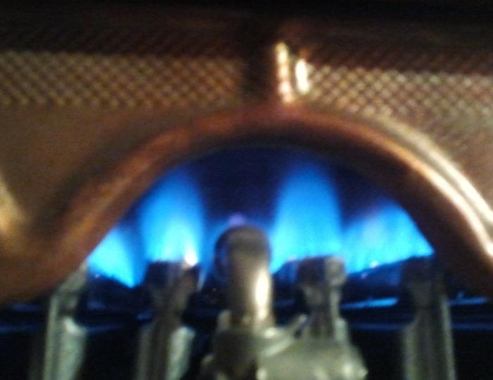

    This is my first post so forgive me if I'm in the wrong section. However, the problem I am experiencing is that my WH only provides luke warm water. The system seems to be operating normally. I turn the hot water on the burner ignites ,the flame is blue , but the water is Luke warm . One thing I did notice is that the heat exchanger doesn't get very hot when the system is on. Is that normal? Also , the flames on the burners only gets about a half inch high from the burners.
    Any help will be highly appreciated.

    Make senses.... So if that's the case the flames is actually what heats the water up correct? I was under the impression the water was heated as it passes through the heat exchanger. I thinking my problem is that my flame is not modulating up high enough to really heat the water properly. As I mention in my previous email my flame only gets about a half to a full inch high. Is that normal? I tried to upload a picture but I keep receiving an error.
Size:  34.5 KB-picture of my flame.

    As I stated before, the flames should really roar (as in much higher than 1/2") at full flow, but should vary with the water flow and temperature adjustment. (If it's set to put out scalding hot water the flames will be higher at a given flow than if its set up to deliver tepid water.)
    The flame front in the picture looks like its stuck at it's minimum modulated fire, or very nearly that. If it's not changing at all between minimum water flow and with the faucet full-on, it's not modulating- it's stuck.

    The slide on the flame regulator appears to be functioning correctly , but the water is still luke warm. Bosh sent me a water valve rebuild kit . I installed it and still no luck. Also , the tank will not come on now unless you turn on two hot water sources. (IE. sink and shower) Do you have any other suggestion to solve my dilemma.

    Something is sticking or maladjusted- it shouldn't take excessive flow to start an ignition cycle.
    When you say it's working correctly, are you seeing an increase in flame height?
    These beasties often regulate the output temp when the flame can't keep up by restricting the flow- it's conceivable that the internal mixing valve is sticking or restricted, but I'm thinking that's what the rebuilt kit should have taken care of.
    If you have hard water and it's been in service for more than a year, it's possible that it's liming up on the inside of the heat exchanger. To de-lime it you have to give it a good rinse with white vinegar for an hour or so, which requires un-plumbing it from the water system. A small submersible sump pump in a 5 gallon bucket with 2-3 gallons of white vinegar running for an hour is usually sufficient. Turn off the gas, disconnect the potable plumbing, and plumb the output of the sump pump to the cold side (or hot) of the unit, and a hose hooked to the other side returning to the bucket, letting it run for an hour or so. (In hard-water country installing them with isolating ball valves and hose connections for frequent deliming is usually a good idea.) Don't put in anything stronger than vinegar or you'll likely damage the heat exchanger.

    Turns out it was the water valve that was malfunctioning. I installed a new and it fired right up.
    However, I do want t thank you for all your help with this matter.
