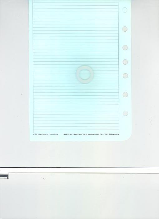

    I found an exact diverter washer for the Price Pfister Diverter Stem Model 9H-3C:
    It is available at the local Mission Ace Hardware Store in Glendora [531 South Glendora Avenue, Glendora, Ca 91741], phone # 626 914 7980 or try to call other hardware stores near your local area.
    This single Nylon washer is packaged by Danco Inc [Irving, Tx, 75062], Stock no. 35692B with PN:
    #16 /bat Diverter Washer.
    The price is $0.99 + tax. Exact same size as in the Pfister Diverter Stem Model 9H-3C. If you encounter a similar problem as I experienced for my two Price Ffister shower room facets, and received absolutely no help from the manufacturer [like my case, either by phone calls or by emails], and cannot divert the water properly even after replace with a brand new diverter stem. I would recommend just Name:  Picture.jpg
Size:  23.7 KBadd additional same size Nylon diverter washer, it should work for you. If this hint help you to fix your problem, share your experience with others if you wish to do so.
