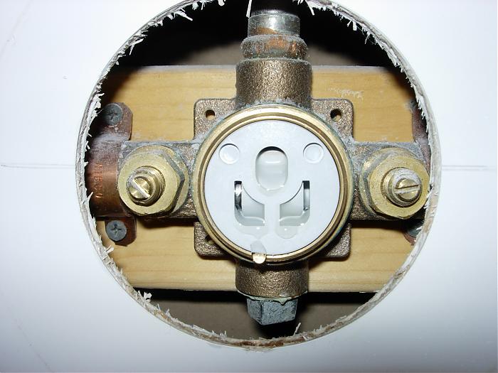

    Hello
    A tenant in appartments where I do maintenance work did not use the shower. Now there is no hot water. The cartridge is not the problem. The cold water works fine but turning the Stop-check valve on the hot feed has no effect. No water at all if the cold is shut off.
    Where might the blockage be?
    I would be very grateful for any suggestions.
    Thanks

    If that valve is relatively new, it has a pressure balance spool valve in it. That is sometimes (always?) separate from the cartridge. If the water was turned off on one side, it can jam the spool valve to the other side. Normally, it'll slide back when both supplies are on, but may not if it is old, or there's some debris in there. This could shut off one side or the other, depending on which supply was on and which was off. Sometimes, a wrap with a rubber mallet will free it.
    23,534
    Pressure balancing spools will stick to one side, usually the hot, if they are not used to keep them loose. I have absolutely no idea which make and model that valve is so cannot advise as to the location of the balancer although that white piece looks like it and the hot DOES have a stainless steel pistion showing which could be the balancing spools shutting off the hot water.

    I agree. I also do not recognize the brand, but I believe hj makes a telling observation. It would appear we are looking at a balancing spool, and it would appeat to be stuck all the way over to the the left, cutting off all HOT>

    Thanks for replies - I replaced the cartridge with a new one. Will try opening both feeds and tapping the valve with a mallet - see what happens.

    I don't know but do wonder about the shut-offs there on the valve. If they are 1/4 turn valves, the slot in the screw needs to line up parallel to the pipe for it to be open. In your picture, the left valve appears to be half way between on and off.
    I changed the cartridge in a moen once, and a chunk of the rubber tore off and jammed in the valve opening when I pulled the cartridge. It caused the same problem. I pulled the new cartridge out and ran the water to flush the pipe, and out came the chunk from the old cartridge.
