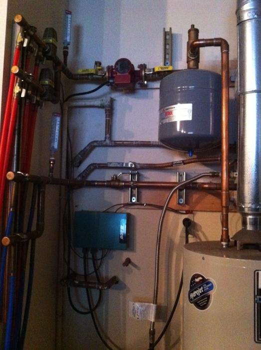

    I have an 8-year old house with radiant heat system in the slab. The system has worked fine for the first 7 winters, but this winter I have new problems.
    The system had been on for several weeks, then started making gurgling noises one night. When I went out to the garage to see what was going on, I could see air bubbles passing through the tubes. I shut the system down immediately.
    My first thought is that I have a leak somewhere, but we've seen no evidence of that.

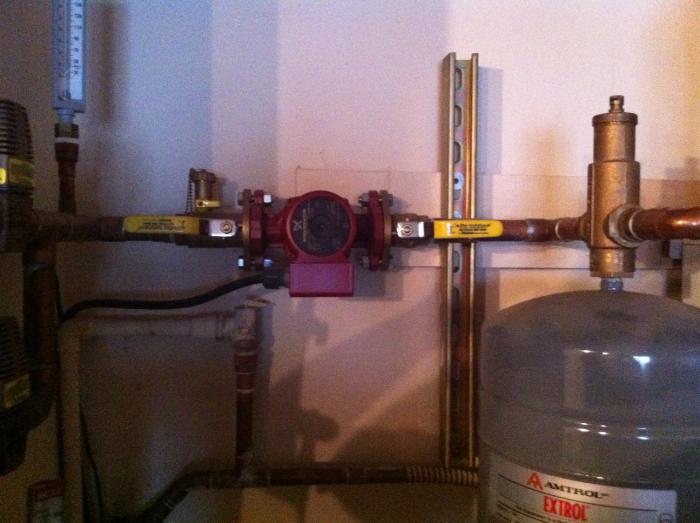

    The system uses a residential hot water heater to heat the water, has a Honeywell Sparco PV100 air remover valve, and an Amtrol expansion tank.
    There is no pressure guage on the system, so I can't tell how much (if any) pressure is left in the system. When the contractor filled the system originally, he simply attached a hose to the spigot on the bottom of the hot water heater and let the public water pressure fill the system. He then ran the pump, circulating the water and purging the air from each zone. when he was done, he disconnected the hose and the system has been at that pressure ever since.

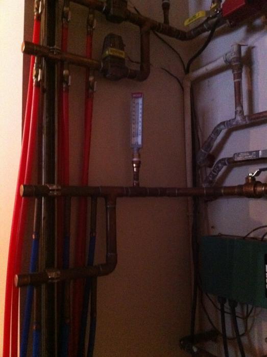

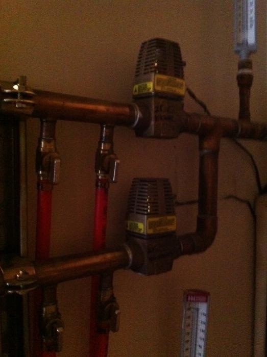

    I've posted some pics below. Note that there is extra copper piping in some of these pictures because the regular hot water heater in right next to the hydronic heating system.

    This pic might make it a little clearer. I've marked the pipes that are NOT part of the heating system with red arrows.

    First suspect is the air valve. But if the heating was working, turn it back on. Water absorbs air quite quickly. wont hur the pump.
    I have an open system and NO air release anywhere. The air was soon gone on its own.
    Why the air relief valve? How would air get into this system? Defeat the valve and try it for awhile.
    Or your amtrol has busted and sent a pile of air into the system.

    Just re-purge the system. Is that water heater the boiler? If so you will probably have to purge every year or so.

    I think the expansion tank is shot, and thats his first place to look. I dont see any "purge" need. As long as the pump has water when running [unscrew the SS slotted plug at the end] to check, let it run and your air will out on its own.
    Only other incredibly vague chance is a suction air leak before the pump, but it should drip when off.
    http://www.pexsupply.com/Honeywell-S...Air-Eliminator
    This is a manual valve, and it looks like you must lift the lever to get the air out. Have you done that?

    If you look at the pic I posted of the valve, it looks different than the one you link to. My valve is venting air at all times unless you screw the cap down.

    The valve is the same model number that you posted. I would screw it down and eliminate it. Leaks in a slab dont put air in a pipe it puts water in the slab.
    Have you yet checked the air tank that has a life span of 5 to 7 years, and is full of air?
    that pump has no rotating seal, it is a wet rotor. The only seal is an o-ring at the housing for changing the cartridge, and the flat face seals at the flanges.
    As long as your air bubbles are small, and the pump gets mostly water, it will soon churn the air into the water. I would also open a valve somewhere in the system and flush out the 7 year old water if its closed system. If its closed, what is your make up water valving?
