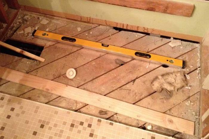

    I think I may have overcomplicated the issue by having assumed that I needed to level my floor. My assumption was based on the belief that I needed to support/level the base of the tub, and I have since come to realize that the tub base on this model does not need to contact the floor for proper installation. My ledger board is level, so that really only leaves the apron that I need to worry about rather than the flooring under the tub. I hope I can simply shim the apron, as Terry suggested, and call it a day rather than worry about the entire floor. The rest of the bathroom flooring is relatively level, so my goal is really only to get the tub installed and level.
    The old tub, which was installed before I owned the home, was not level. The old ledger board was not level and I believe it may have been installed too high. I am including a photo taken immediately after the old tub was removed. I have since replaced the ledger board, taken out the drywall, and put down new 1/2" plywood over the planks. I didn't do anything to the planks, but they seemed sturdy/stable, though generally uneven. I stapled the plywood to the flooring. The shape of the plywood seems to have inherited some of the uneveness of the planks, but it is at least well-secured so that it does not bend/shift, etc.
    Do you all think I can simply install the tub over the plywood, shim the apron, and proceed from there?

    Jul 2009
    North Vancouver, BC
    1,577
    http://www.americanstandard-us.com/a...stall_1011.pdf
    I looked up your spec while having lunch and have not seen a tub that sits on the apron before. The installation guidelines say it does not need to touch the subfloor but I might call the tech department to see if it can. If so a mortar bed underneath would make setting the tub easier.
    If there is room in the back side of the front apron for a mini curb it might be possible to set the tub level with shims and then pack in cement product to pick up the weight on the front side. Remember that if the floor flexes and you have the tile touching the tub you could get squeaking after the install. I would use some sill gasket or such as a temporary bond breaker from your tile floor and the apron face if it is going to slip below the tile floor height.
    Wish I had first hand expierence on this model for you.
    I also don't like the roofing nails that tight to the tub as shown in the diagram. I prefer a little space so there is some room for expansion. a few layers of electrical tap will give you a little space between the nail and the tub.
    JW

    Thanks for the response, John. These instructions you found, from what I can recall, are nearly identical to what shipped in the box for my 2390 model of this tub. The instructions did not mention a mortar bed, but I found an alternate version of the instructions on American Standard's website for the same model I have. Those instructions add that a mortar bed is acceptable for my tub. The way that things will work out after I shim, is that the base will be raised slightly off of the plywood. I plan to include a mortar bed into the installation so that the base is set in the bed.
    Just so that I understand you correctly regarding your suggestion to pack in cement product, are you referring to filling the gap that would present itself under the apron between the high side of the tub and the shimmed low side? Is the intent to allow even distribution of the weight along the apron rather than at the ends?

    I would set it up so you get good coverage under the tub bottom itself. We like to use 6 mil poly as a bond breaker between the tub and the subfloor.
    I would set it up with a couple of shims on the apron side so once you press the tub into position it can't go any lower. This might be difficult depending on the tub's relation to the tiled floor. Often a tub will have a few inches of clearance between the tubs bottom and the subfloor. You can infill this area with a little scrap plywood and leave some room for the mortar mix to fill. With a couple bags mixed up you can place this in the center of the area and then drop your tub down. If your shims are right and the ledger board good you can wiggle the tub right into position.
    Once set you can the next day pack in more mortar under the apron to infill some more. I would imagine that apron has a good 3/4" of width to it.
    The poly as a bond breaker will allow you if need be to remove and replace the tub for what ever reason.
    Do you have access to hook up the tub's overflow and waste from the side or do you have to work entirely from above? Much easier not to have to do it this way.
    Do you have solid blocking around the perimeter of the tub's tile flange? This makes for a solid install and offers up the best protection from leaks at this point.
