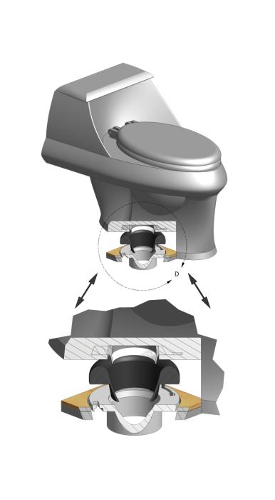

    We have a new waxless toilet seal.
    It is extremely EASY to install and made of flexible, durable materials that are guaranteed to last.

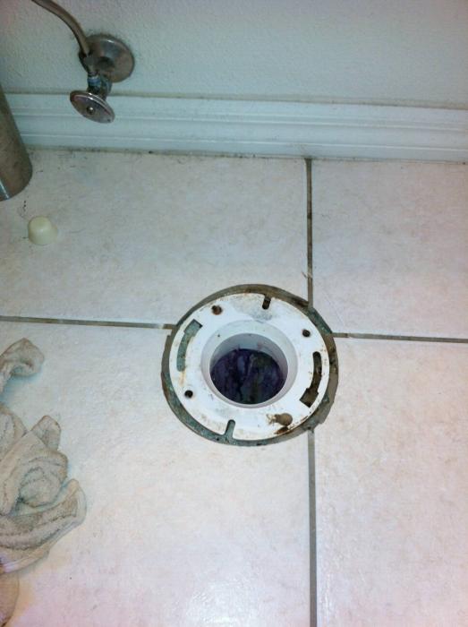

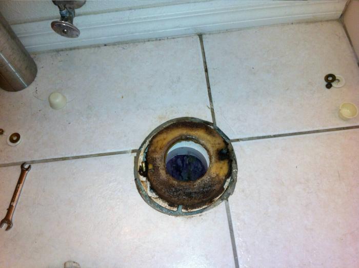

    I have installed 3 SaniSeal Gaskets as of yesterday and a 4th today.

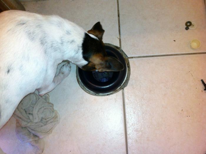

    My wife was complaining about an intermittent sewer smell in the mater bath of the vacation home. (I did not smell it) My Sewer sniffing Jack Russell Terrier alerted to the source. Today I pulled the toilet and installed a new SaniSeal to replace the wax ring.
    I intend to replace the vacation home tioilets with a couple of Totos in the near future being I installed 2 Toto Drakes (using SaniSeal Gaskets) in the primary home bath remodel recently and my wife loves them. Now have to replace the vacation home toilets with a Totos. Unfortunately they both have Banjo counters over them so the Universal height Drakes will not fit.

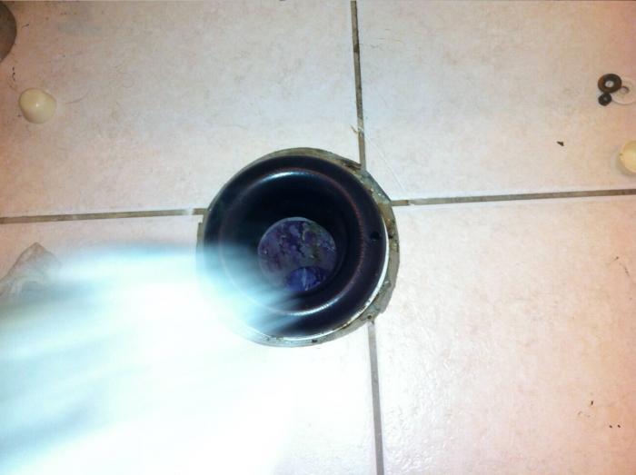

    The toilet that I worked on today was rocking a little and I suspect that the wax seal did not completely remain sealed, as alerted by the Jack Russell.
    With the Banjo tops it was a little tricky to line up the toilet, being I had to move it around before it would line up exactly. With the SaniSeal holding the bolts upright, yet letting them move around a little, it was a snap.
    See pictures taken today. .
