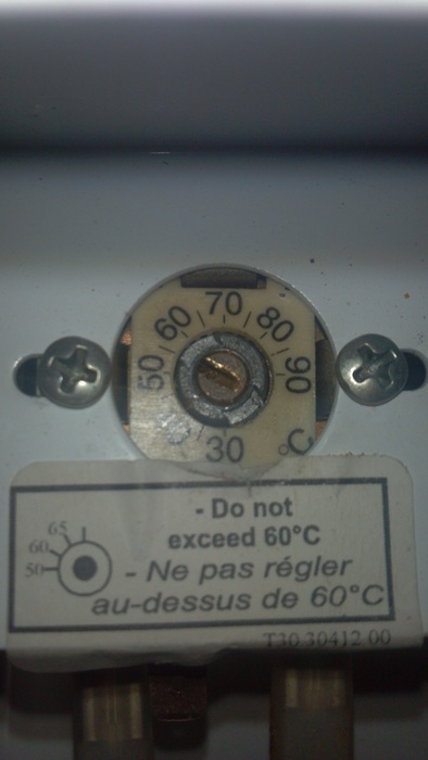

    What does the suspect part look like? (Can you post a pic?)
Size:  62.7 KBThe front of the thermostat is covered by a white plate that is part of the boiler housing. There are two screws holding the unit to the plate. Between them there is a dial with Degrees C from 30 to 90 (30 is at the bottom and 90 at three o'clock) in ascending order clockwise around a brass flat screwdriver slot that is slightly eccentric so that it is possible to tell which degree mark towards which it is pointing. Around the brass slot, there is a grey metal ring. The control is about three centimeters square and 1.5 deep. There are three male spade terminals on the bottom. (Only two are in use.) On the back is one Phillips screw. The sensor is a one meter or so long copper tube about 2 mm in diameter. It may have a bulb on the end of the tube since something hard hits the inside of the fitting on the tank when the tubing is pulled.
    Photo? There is not much to see unless I pull it out again, and those screws are tiny and it is late. It is taking so long to transfer the photo I will post it later if/when it comes from the camera.
