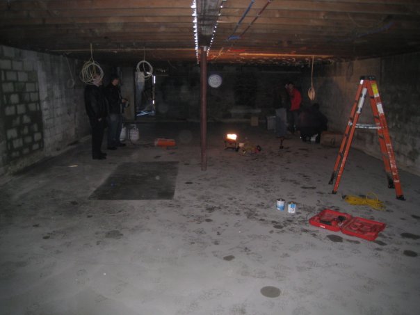

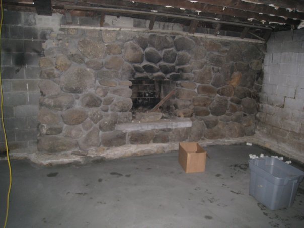

    The top pic is rockwall fire place I am just gonna clean and use and the Bottom pic is the basement before plumbing and hvac ducts all the ducting is on the left side ceiling about 4 " below the I-beam

    Overall plan sounds good to me.
    Why are you insulating around the furnace on the floor? You should create a separate room for the furnace, with 3' clearance around it, and leave the floor cement in there. insulate the walls of the furnace room, not the floor. Same thing probably applies for the water heater, I'm not sure what kind of clearances are required for a tankless, but I'd probably box out around it and insulate the box out, not the wall its mounted to. make sure you're venting/fresh air supply is not effected by this arrangement.
    On a job this large, I'd consider doing your 2x framing with a gap between it and the wall of whatever you want, and having it professionally spray foamed with closed cell foam. This will give a better air tight seal. You'll have to get input from people like Dana about all the ramifications of this process as far as moisture control, as he obviously knows far more about it than I do. It should cost in the range of $1.10 per board foot (one square foot, 1" thick), but is very good at what it does. Most formulas are at or close to R7 per inch, it adds structure to a building, is completely air tight if installed correctly, and pretty moisture resistant. Again, I defer to Dana and others for the proper moisture control of this setup. Personally for a basement, I'd frame it 1" away from the wall, even if you need to notch over the footer to do so, spray that entire cavity full of foam, and then fill the 2x4 framing with R13 fiberglass and call it a day. You will get a total of about R19-R20, but its a completely air tight assembly, so it far outperforms a typical R19 fiberglass installation in 2x6 walls.
    i wouldn't bother with CMU on the bottom, personally. I'd just use MR the whole way, holding it up about 1" off the floor to avoid picking up any moisture from the floor. Alternatively, if you put your 1.5 XPS on the floor right up to the footing, then frame on top of that, you wouldn't have to worry about gyp board to cement contact at all, and you'd have a tighter insulation seal. The paint texture difference between the 2 boards would be unacceptable to me if you use both CMU and gyp board. a tight seal and low humidity is all you need there.
    For your ceiling, if you want the look you are describing, I would do something like what you are saying and not attach the 1/4" boards to the ceiling at all. Make your seams on a 24x24 or 16x16 pattern (something that works for your joist spacing) and only attach the trim to the joists, letting the panels float. if you want to get fancy, you could rip your 1x2's into a "T" shape, creating a notch on each side to carry the panels, and the middle unnotched part can sit directly on the wood studs. This will ensure that the panels are not sandwiched tightly against the studs by the nails holding the trim to the joists. on a table saw, this would be a quick job, just make a 3/8" deep by 1/2" wide groove along the top of each side of the 1x, allowing the panel expansion room and 1/8" of play up and down so that it can't be pinched in place. It will also reduce the thick/chunky look of the 1x trim.
    The installation on a macerating toilet system is nice and quick and easy, i can't comment on their longevity. Around here, drain lines are almost always below slab, so i always plumb directly into them. I think there are some other preferred options rather than a maceration toilet, but I'll let the plumbing pros answer that one. The value/convenience added from this bathroom would be worth it in my opinion. If you can hide the equipment for this in the furnace room or something, it makes access/service easier, and looks better. Not sure what your layout looks like/if thats possible.
    Jan 2009
    01609
    1,993
    2" XPS on the wall would be a max, not a min. At 2" it's about 0.6 perms, and given that you've had moisture issues it might be better to keep it over 1 perm (1" of XPS or up to 2" of EPS.)
    Do NOT leave a gap between the foam and the batts, as that will allow convection loss performance within the batts (which require a tight air-barrier on both sides to meet rated-R), also leaving a potential unobstructed thermal bypass air currents. If you can't get the studwall any closer to the foam, use R19 batts and compress them to fit. Be sure to use sill gasket (or the floor- XPS) under the bottom plate of the studwall to eliminate capillary wicking of moisture into the wood.
    Use only UNFACED batts, no interior vapor barriers, or you'll essentially have buried the studs under ground, where wood never rots or molds, right? :-) The foundation & studs need to be able to dry toward the interior via vapor diffusion- use only standard latex as the interior finish (2-3perms), and avoid vinyl or foil wallpapers, etc.
    You can use duct mastic to air seal the seams of the EPS, or use housewrap tape if it's XPS, but sealing the foundation sill to the foam calls for a spray-foam solution, at which point you might as well spray-foam insulate the band joist as well. Closed cell foam is about a buck a square foot per inch of depth if doing the whole wall, but doing just the band joist & sill on a 25x50 rancher with 2x10 (9.25") joists would run ~300 board feet at 2", including sealing over the top of the wall-foam and top plate of the interior studwall. This is a DIY project using an online kit, but if you're doing it now use the "cold weather" forumulations or you'll have expansion & bonding issues. A 600 board foot kit is ~$650-700 shipped call it $750 with extra tips, tyvek suits etc. A 200 board foot kit is ~$350 shipped. A pro would probably nick you $1500 since it ties up the truck & crew for a partial-day (time is money), but if the state will give you a rebate (see masssave.com) it might be cheaper to let them do it. Call some contractors, tell them the size of the job, and ask about the state rebates.
    Framing an inch or more away from the wall and spray-foaming with closed cell to fit as mtcummins suggested would work, but it's a lot more foam $ even at a 1" nominal depth. At 1" of closed cell you'd be at about 1-1.5perms which is fine, and at about R6 (also fine, from a wintertime dew-point calc point of view.) Virgin EPS is ~10cent/R/square foot, compared to closed cell spray foam @ 17cents- probably more if it's under a couple thousand board-feet (time is money, and tying up the truck for half a day costs something.) Reclaimed roofing EPS is typically about 3cents/R/square foot, and about 1-2 perms @ R10 (2.5"), (well worth a trip or two to Framingham with a pickup truck.)
    Leaving a gap in the floor insulation around the heavy mechanicals is fine. As long as you have at least 1/2" of plywood or gypsum as an ignition barrier at the edge you can take it as close to the water heater as any other wall material.

    So let me see if I completely understand
    I definitily have the issue of the original footing at least 3" from the original block wall, the back of the framed wall will not be able to begin for this distance so I would like to do as thick of a board insulation on the block wall as possible, So It seems I should use 2" EPS and R19 unfaced batts in the cavity of the new framed wall, because the R19 is 5-6' deep and will be able to press tightly up against the 2" eps...right?
    I am not to keen on spray foam because I think I will need alot more than the above set up, but if I was to do foam would I still do the EPS on the wall? also would the foam be sealing in a the electrical in the wall and above it?
    The part thats not getting through my thick skull is where the floor meets the stud wall. If I put 1.5" XPS right up the lip of the footing that sticks out and my bottom plate right on the edge of the XPS is it possible for the XPS to compress under the weight of the framing and cause the wall to shift? If I do XPS on the floor and put my bottom plate right on top should I use a can of great stuff to seal the inside between the EPS wall, the XPS floor and the footing lip?
    As for the ceiling I am more looking for ease of access then fancy look especially because it will not be uniformly flat accross the span of the basement. I was just thinking of using 4x8 sheets 1/4" thick, I dont think I will be able to attach directly the the joists because the plumbing pipe are lower than the joists and I want to hide everything, as best as possible.
    Sorry if I'm a bit thick when it comes to these things I am very new to this stuff and have always paid someone to do any major things like this but in this excellent economy were in the budget is tighter than before so I am going at it as a diy project. I cant thank you guys enough for the advice.
