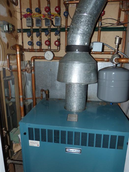

    Take a picture of the boiler, front on so that I can see the whole front of the boiler and I will get back to you.

    Thanks for the helpful replies! At Tom's request, I've attached a photo of my boiler. Thanks for the suggestion -- I should have done that a while ago.

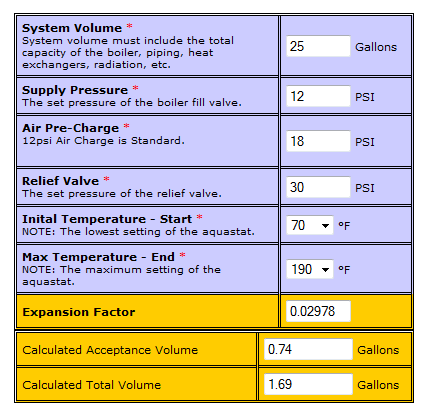

    Thanks Jim. Here's my quick math:
    House is at most 40' x 60', so perimeter is 200'. Suppose piping for each zone goes all the way around the perimeter of the house. 200' x 4 zones = 800'. Add extra footage for supply and return between the levels of the house, and I estimate 890' = 10,680 in.
    Assuming pipe diameter of 3/4", radius is 3/8", and pipe cross-section area is 3.14 x 0.375 x 0.375 = 0.44 sq in.
    So total volume = 10,680 x 0.44 = 4716 cu in.
    Using 231 cu in per gallon gives 20 gallons. Adding a few for the boiler itself I have maybe 25 gallons at most.
    This is probably a conservative (that is, high) estimate -- each of the zones actually covers about half of a floor, so total pipe length is surely less than 890'.
    The rest of my inputs to the Watts calculator are in the screenshot attached. Calculated total volume is 1.69 gallons and acceptance volume is 0.74 gallons. Extrol 30 yields 4.5 and 2.5, respectively. Given that I'm pretty confident that I overestimated the water volume, it seems like the Extrol 30 should be more than sufficient size. Does that seem right?
