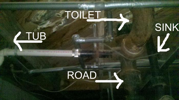

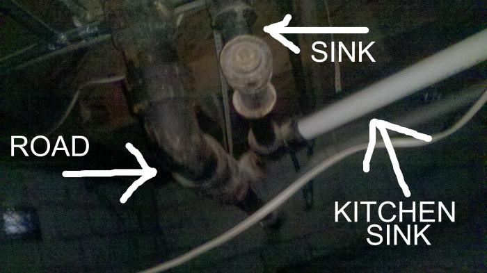

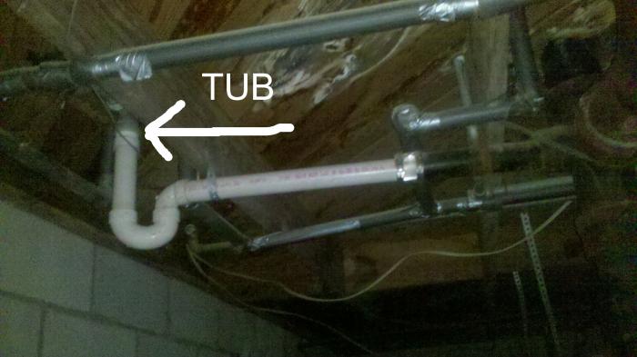

hello to everyone,
I have an older home and my sink will not drain unless you let it sit for a long time. when you walk into the bathroom you have the sink to the right, a toilet next to the sink and then a tub next to the toilet. i looked under the house and all 3 pipes run together and go to the street to drain. I have pulled the pop up out and cleaned that, i took the p trap out and cleaned that i snaked the drain pipe with a 25 foot snake and there was nothing blocking it. what could be wrong? could this be a vent problem? if so how can i fix it? i would think if it was a vent problem then i would be having problems with the toilet and the tub but they drain fine. any help and i would so thankful.

Post some pictures please, of the piping under your sink as well as whatever lines you were able to see underneath, where you said they join together and go to the street. This will help us in trying to determine your problem.

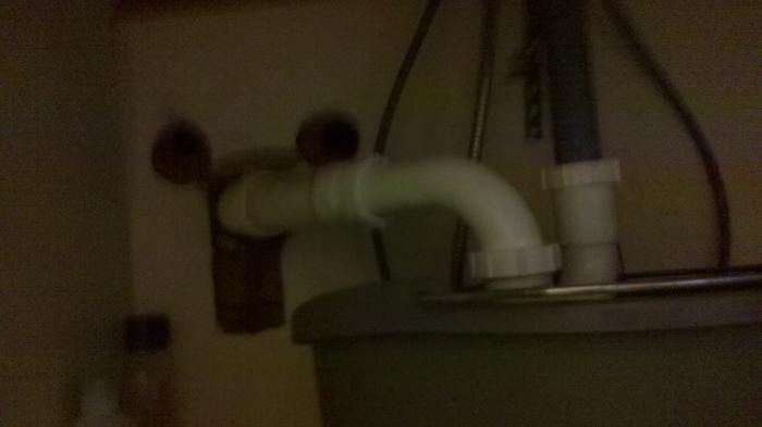

here is under the sink. i am not able to get a pic of under the house but i will try to get one. 2011-11-20_14-04-34_740.jpg

Nothing looks obviously wrong under the sink. Is there a vent line coming off the top of the Tee where the drain line enters the wall? I can't see that from this picture.
Technically, a clogged or missing vent shouldn't slow down or cause a clog in the drain. Its primary function is to ensure that water remains in the trap and sewer gasses don't escape into your house. There is a small effect of helping water move more quickly as the drain can cause a suction force and the vent allows air to freely move through, but this is relatively minor. The lack of a vent won't cause a clog, but could make an existing problem get worse than it otherwise would.
You probably have a problem under the house, but w/o seeing it, its hard to say.

no there is not a pipe going up into the wall...it just goes down when it goes into the wall...

Your first picture shows a cleanout at the end of the line labeled "sink". Snake the line through that cleanout. It may help to run water down it at the same time to flush it out.
We cannot see all the bends, but using that cleanout it should be pretty easy to determine if the restriction is above or below that point.

ok i will do that next...and as far as the bends what you see is all i can see...the pipes come out oc the floor and come straight down and then you see then from there.

does the kitchen sink flow easily? If so, then your problem is between the downturn of the pipe under the sink and where the kitchen sink ties in. Most likely it is in the horizontal portion by the cleanout. shine a light down in there and see what it looks like... it may be time to chop out a section there and put in some new piping, that horizontal part is probably corroded all to hell and making the water flow slowly, catching hair, etc.
also, you have no venting whatsoever in this setup that I can see, other than some wet venting from the main stack. if i were you (without going to the huge trouble of putting in a proper vent which would be the right fix), I would cut into that horizontal PVC line under your sink back near the wall and install a Tee with the Tee part pointing up and the curve going towards the wall, go up about 4-6 inches, and install an air admittance valve. a little air flow behind that drain won't hurt, and if nothing else, will prevent sewer gas from entering your bathroom.
