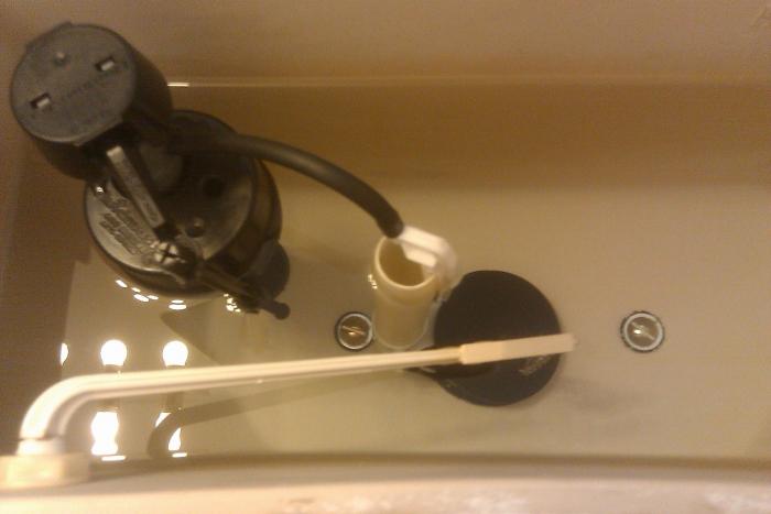

    I have a roughly 12 yr old Gerber 28-790 toilet that will run for 2-3 seconds every couple of hours or so. I have replaced the fill valve (fluidmaster), the flapper and the seal on the bottom of the flush valve. I have not replaced the flush valve or the seal between the bowl and the tank. Mainly because I am having issues find the correct parts in a store. I have tried adjusting the water level several times to no avail. Not sure how high or low the water should sit in the bowl, or if it matters. Tried the food coloring test, nothing running down the sides of the toilet but the water was blue in the very bottom of the bowl. It looks like a leak from the tank to the bowl? Maybe the gasket is bad? I do notice some small air bubbles around one of the bolts that holds the tank to the bowl and around the flush valve seal. Maybe they need to be tighter? I have them really tight now not sure what the deal is with that. Any help would be appreciated! Thanks!!

    Well, did you actually replace the rubber flapper valve? I see one thing that isn't right...there should not be a metal washer on the tank/bowl mounting screws...the head needs to just have a rubber washer underneath it or eventually, it will leak. It's possible, but unlikely at this point (would have likely noticed it when new, not after awhile), on the bottom of the tank, the big nut that holds the overflow, flapper valve seat assembly in place.

    the rubber washer under the tank bolt wouldn't allow water to leak into the bowl, it would be running down the outside of the toilet bowl. the right one looks worn out, and it would be better to not have the washer in there, the head of the bolt is sufficient, but this isn't your problem.
    this looks like either your flush valve flapper is not sealing tightly to the flush valve, or the seal under the valve is leaking. the gasket between the tank and bowl would not cause this either, this also would let water drip down the outside of the bowl while flushing. if it were me, i'd just replace the entire flush valve assembly, new flappers on old valve assemblies have given me trouble too many times.

    That thinking also says to buy a new car when the ashtray is full. Those metal washers under the bolt heads MUST be removed, because if they are not leaking now, and it would be a "miracle" if they weren't, they will sometime. IF the overflow riser is not cracked, then you problem is a bad flapper, and they CAN be defective even if they are new.

    For future references....IF the Bowl and floor around the bowl is NOT wet there are 3 places to look...obviously the Flapper and flush valve. IF either one is out of shape or cracked etc that will allow water to leak into the trap.
    Secondly, has the Flush valve losened up with time or been replaced and not tightened/torques enough, proper washer etc? IF the flush valve Rubber Bevel washer is leaking for any reason...and IF it is an original Gerber from the Post 1.6 days it should be a design that prevents water from leaking onto the floor. Check tightness of the flushvalve by reaching into the tank. Try to turn the flush valve with your hand. IF the FV is Lose the it must be re-torqued from the tank bottom.
    Lastly, on the Fluid-master Ballcock or fill valve, the Water Level adjusting mechanism can become lose where the "Slip Fastner" holds the float in place. Check to ensure this isn't lose and allowing the float to slip....I truly suspect the flapper is not sealing off for whatever reason.
    One last thing. Turn the water off to the tank. IF you are going to be away for a couple days this is a very good test. See if the water is down in the tank only or tank and bowl....Hope this helps everyone in the future. TD
