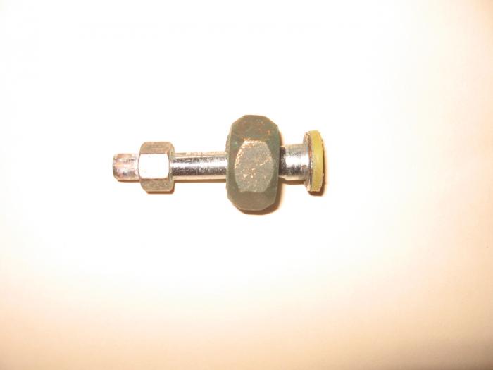

I've got a 1950's one-piece toilet, and needed to replace the fill valve. Problem is in duplicating the supply line. There's a half-inch chrome water line coming horizontally through the wall, ending at a chrome toilet valve. From there, a compression fitting on top connects to a short piece of 3/8 chrome pipe that ends in the 7/8 nut that connects to the fill valve. The length of that pipe is only 2.5 inches. The original piece was bent in the initial install, but apparently never leaked. But the modern fill valves have threads that are about half an inch longer, and the original piece would need to be bent further to make it fit.
So I went to the plumbing supplier to look for a suitable replacement, but the guy there said no one makes anything like that, in either rigid or flexible tubing.
The shortest flexible/braided line I can find is 6 inches, which is way too long, and there's not enough room to make a loop without really putting sideways pressure on the fittings.
Anyone know of a way to make this connection?

Here's a pic of what I'm trying to replace
The problem is that the bottom of the fill valve and the end of the horizontal section of the supply line don't line up, and the riser portion is really short, not allowing much room to bend, if its even supposed to be bent at all. But I guess if no one makes tubing this short out of anything flexible, I'll have to force it into position. That looks to be what was done originally.

Those typically come a lot longer and you cut them to the needed length, and, they are soft copper so are designed to be bent to get them aligned. It's really hard to do it on a piece that short, though.
As Terry mentioned, if you can rotate the supply valve a little, it would allow you to use a hose with a loop. Instead of having the outlet point up, point it down with a loop in the supply. This should give you enough room to make the connections.
