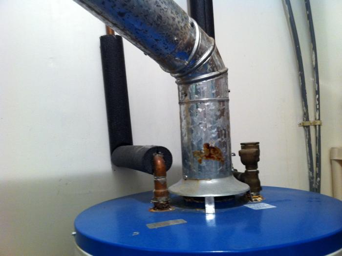

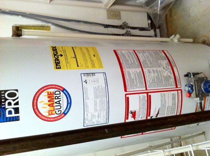

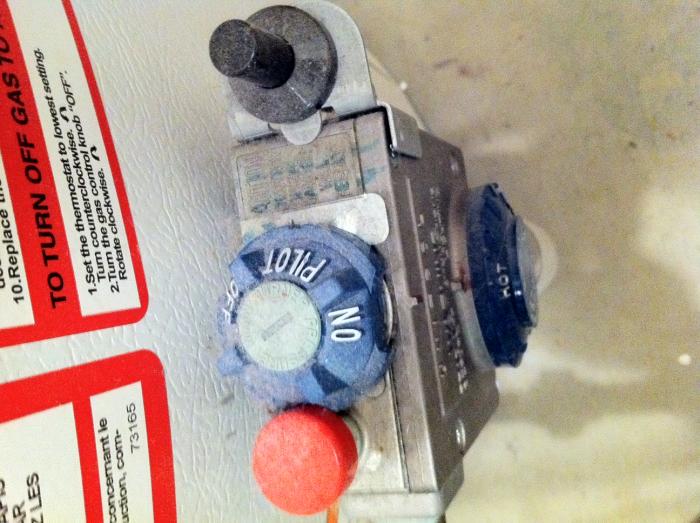

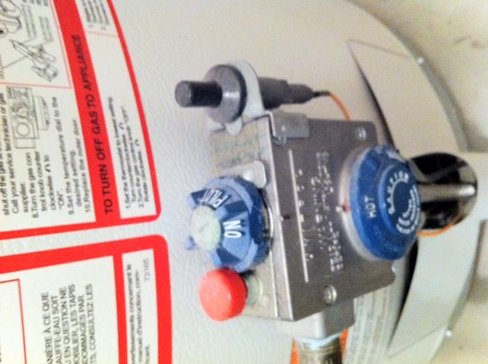

I attached some images of my Water Heater and the dials. Is one of the switches in the wrong place?
It's a Gas heater.
They look okay. Does the burner actually come on? Is the pilot lit? The more likely problem, if the tank is working, is a cross-over or bad tempering valve.
Follow where the lead goes from the pushbutton for the ignitor...it goes near the pilot light. There's a cover you can remove to check it. If you use a lot of hot water, it should be obvious when the burner turns on both from the sound and that that flue will get hot. The pipe coming out the top would also be warm to hot (actually, hot, since you have the aquastat turned up to HOT). It might cool off a little when no water is being drawn, but conduction will keep it pretty warm regardless, if the thing is on.

It sounds like your burner is off. The control is now set at on ( little tab on the front of valve is the indicator.)
First, remove the metal cover below the valve. Peek through the little glass window. You should see a small pilot flame. IF NOT:
> turn the gas control to off, temp to "vacation"
> set control so the word 'pilot' faces front. The half-moon cutout in the control will allow you to depress the red pilot button. Holding that down, now press the black sparker, observing through the glass window. Repeatedly press the sparker until the pilot flame appears. CONTINUE holding the red button for one minute after you get a pilot flame. Now turn the control to "on", turn temp to 'warm'. You should see and hear the main burner ignite,

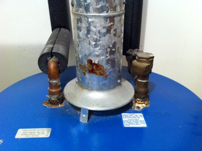

From the looks of the corrosion between copper and perhaps iron nipple made by some dope, I would say you have a leak.
