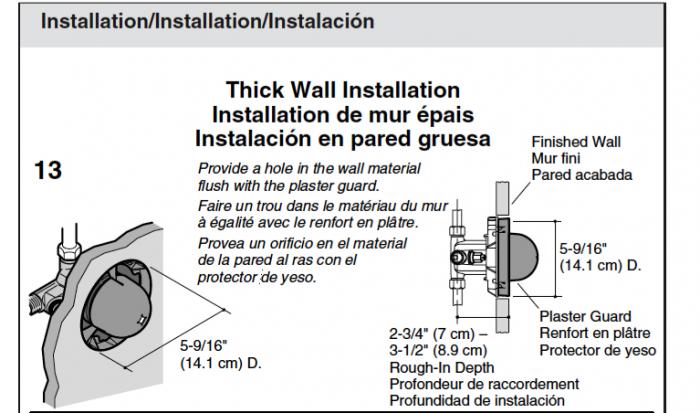

    quote; When they say "thick wall", they mean a wall that is already finished with tile, stone, etc. But in either scenario, the plastic disk has to be behind the inside of the wall.
    That is almost completely wrong. With a "thin wall which means the side of a modular tub or shower, there is enough latitude that the plastic ring CAN be behind it with the wall clamped between the disk and the trim ring, but that is COMPLETELY DIFFERENT than a "thick wall where the ring MUST BE even with the finish wall, NOT "behind the inside of the wall". IF you do it that way you can be almost positive the valve will be installed to deeply to finish it without an extension kit.

    OK, with that knowledge, I looked at the installation guide again, and it looks like they want the plastic guard ring (which is kind of clipped onto the permanent ring) flush with the finished wall. By finished wall, do they mean the edge of the tile or stone I will finish it with? Or do they mean the edge of the durock?
    If it means the tile/stone edge, then I would account for what will go on top of the durock: thinset, kerdi, thinset and 1/4" tile. How much should that be all together- a little less than 1/2"?
    I'm attaching a shot of the "thick wall installation" section.
    Thank goodness for you guys.

    Finished wall. Now, I highly suggest that you momentarily attach the trim and see how things fit. Some of the Kohler stuff is VERY precise, and if you're off even 1/16", the trim won't fit. Most have more leaway. You won't know until you actually attach it. Then, there is probably an acceptable range, and you may not like it t at the min or the max, so to get the handle where you really want it, and so the trim will actually fit...do a test fitting. The thinset, Kerdi, and tile will probably end up about 1/2", but again, it might behoove you to do a mockup of that as well, especially if the valve/trim you have is one that is very critical on their placement.

    The trim arrives tomorrow, so a dry run is the plan. It will be interesting to see how much this "twist" in the valve will affect things. With the way things are going lately, I will hope for the best and expect the worst. I'm thinking I will slap another piece of 1/2" drywall or durock over it and then fit the trim, so it will mimic all of the layers that will be on top.
