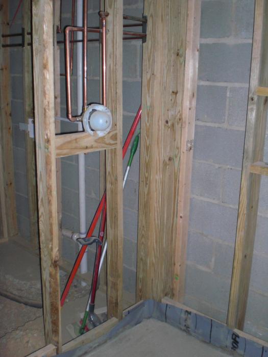

    Hi Everyone, I wasn't sure if I should post this in the shower forum, but since it has to do with rough-ins I posted here.

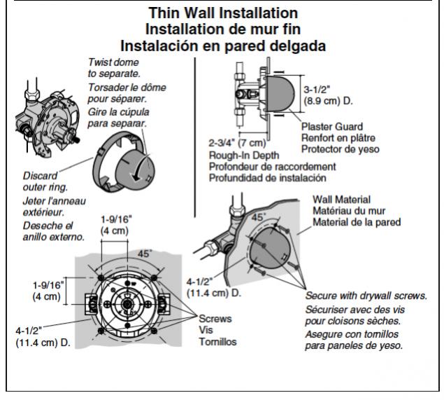

    My issue- I had a plumber run water lines over to a bathroom where we were adding a shower and install a Kohler K-304-K Rite Temp valve. When he put it in, it looked like it was sticking way too far out from the studs, but when I pointed it out he told me I had misinterpreted the instructions, that he had been doing this for years and years- yadda yadda.

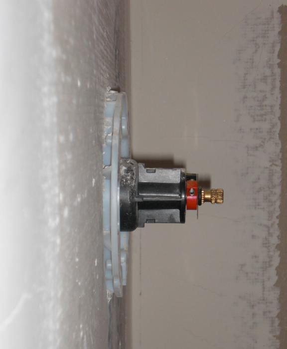

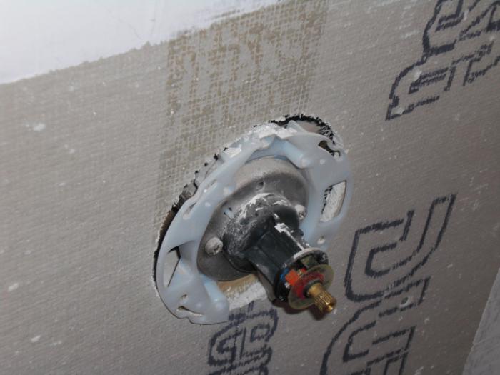

    Well, I put up the durock, and after reading the installation about a thousand times, looking at videos, etc- I have a big problem. Two, possibly. First, he did install it WAY too far out on the studs. The plastic ring is supposed to sit behind the durock, but it sits a good 1/4" outside of it... on one side. On the other side, it sits outside the durock about a 1/2"! So now, not only is it too far out, but it is twisted about a 1/4" to the left.

    I am attaching photos of the rough in before drywall, the install manual close up, and the valve as it looks with the durock around it (profile from the side, and then top view so you can see the angle. The dome is not on the valve in those photos). What kills me is the "very tough" plumbing inspector looked at all of his work and passed him. I guess they don't really look at the details when doing an inspection?? Who knows.

    No doubt that is a pretty sloppy installation indeed. The tile will take care of the 1/4" side without any problems but the valve needs to be even all the way around or the escution is going to look like crap. I think your best bet is going to be to re-set the valve.

    Oh, I'd rip you off big time just to teach you a lesson LOL. Not really no, It all depends on the going rates around DC I suppose though it should only take about a half hour.

    There appears to be no hangers or supports at all other than the 2x4 below the valve either. Looks like the whole thing kind of swings in the wind.
    I once had a couple of "pros" (working under someone else's license) do the same thing to me, and I just did some careful tweaking and bending to get the valve into place where it needed to be. If you can still get to the backside there, I would cut the 2x4 back away from it, do a little manipulating and then add whatever would be needed to re-fasten the valve to the studs.
