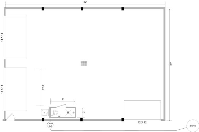

I’m roughing in under slab drains and trying to find a way to properly vent a floor drain. The problem is that the catch basin for the drain is in the middle of an open floor with the closest wall for a vent 20 feet away. How can this be vented?
I’d like to use 2†pipe if possible, but could use up to 4†which connects the building to a septic tank. The connection will also serve a toilet, sink, and shower.

If you are even thinking about connecting a toilet to it, then it HAS to be either 3" or 4". We cannot even begin to tell you how to vent it without seeing the structure.

Here is a sketch of the building
I have 4†ABS to the building. After that I’m planning to reduce to 3†and have a 3†– 2†reducing wye to the shower and a 3†wye to the toilet and floor drain. I think I’m clear on how to vent the shower, sink, and toilet. There will be a 3†vent stack near the toilet for venting those.
In the middle of the building is where I want to put the floor drain. That’s what I don’t know what options are available for venting.
Does that help?

You have to have a trap inside a structure or you will have an open pipeway from your septic.
I would go with either a 3" or 4" line to the trap. From the trap you can put a bushing in on the vertical and use 2" there.
By oversizing the waste line, you allow air over the line to naturally vent the waste line and prevent siphoning.
The oversized line acts as both waste and vent.
A trap primer keeps the trap full so that sewer smells don't ruin what could be a pleasant experience.

That helps and seems it would work fine. A couple things I'm not understanding though:
1) Some vent tables I saw listed 10' as the maximum distance for a horizontal 4" pipe that had waste and also acted as a vent. Am I misunderstanding that and is it OK to run a 3 or 4 inch pipe like you descibe 15 feet before it has a vertical vent?
2) The local inspector said I need an oil / water sererator. Is this normally the case? I'm not planning to dump oil down the drain, but want to be able to hose the floor off into the drain.
thanks!

I just want to be able to wash dirt that gets tracked in off the floor into the drain. The local plumbing inspector said it needs to go into the septic and not onto the ground like the gutters.
I'm planning to use for vehicle storage, but the requirements seem like they are considering it more like an automotive shop and trying to protect from someone dumping oil down the drain, or onto the ground.

Most localities won't allow a floor drain to be installed in a garage because anything that leaks from the vehicle can end up in the sewer.

They won't even allow oil water separators around here. Probably because nobody ever cleans them out and eventually they fill up and overflow into the drainage system. We installed a self contained floor drain system for a large diesel garage a few years back. Floor grates and drains all feed into a 2000 gallon lined tank with it's own pump and alarm system. It's underground so the self contained pump is to pump the tank into the recovery truck when it's full. No part of the system is connected to the sanitary sewer system. And the permits and inspections...let me tell you about the permits and inspections on that one Oyyyyyyy

That makes sense and I really don't want to run it in the sewer either. But the they don't want it run out on the ground either.
Have you seen cases where they might allow an oil / water seperator, then run onto the ground?

He ALREADY has a 1500 gallon oil seperator: his septic tank.
Any one following the decomposition of oil, used or new, would know that a few drips a day of oil into a private septic system would be happpily digested by the trillions of hungry bacteria.
