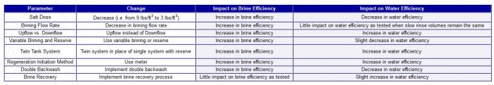

    I was going to give you an explanation of variable brining and then I remembered this from awhile back. It's a pretty good synopsis of what variable brining is all about and how the Fleck 7000 handles it.
    http://www.catalystsystems.org/?p=96
    Personally, I'm not sure just how much money variable brining is going to save you especially when you figure in the added equipment cost but to be honest I sell the stuff, and install the stuff and tend to believe what my distributor tells me about the stuff and unless I have a customer complaining about the stuff I rarely see it again. I suppose I could try keeping track of selected customers salt use and such but.....that's a lot of work and the figures may be skewed also and since they are happy, why open that can o worms.
