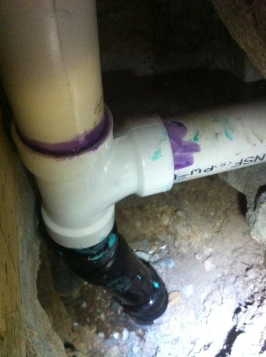

    So I just installed a bathtub and I've got a leak! The floor is slab on grade. I used some of that green PVC-ABS transition cement. Obviously I couldn't do the normal 1/4 turn when I dropped in the tub, so I just sort of crossed my fingers as I dropped the tub in and as it dropped in, guided the ABS tube into the PVC elbow.
    As you've probably guessed, when I filled the tub the next day, the damn thing leaked from that fitting. Not a huge leak, mind you, but enough to get some spots on a "witness paper towel" i folded around the joint when I drained the tub.
    So, now what do I do? I can't really move the tub at this point (set it in a bed of mortar and adhesived down the leveling feet). This is a crazy tight location. Part of me wants to say, "Heck, it's underground, just ignore it." but that part of me knows I'll always be thinking about it. I'm considering perhaps cutting the PVC tube that runs up to the overflow and trying to glob some cement over the inside of the joint, and then repairing the overflow tube with a Fernco.
    Help!
    Here's a picture of the situation

    You could cut out the fitting and go with a banded coupling.
    Adding more solvent isn't likely to do anything for you.

    I used Kohler K-7272 overflow drain which is the only drain that will work with this tub. It's all PVC. The overflow housing is PVC and is welded to the overflow downtube. The drain ell is PVC and is welded to the waste PVC tube. At some point I have to connect PVC to ABS. Not sure how else to do it other than I guess with a Fernco, but I'm very curious at this point!

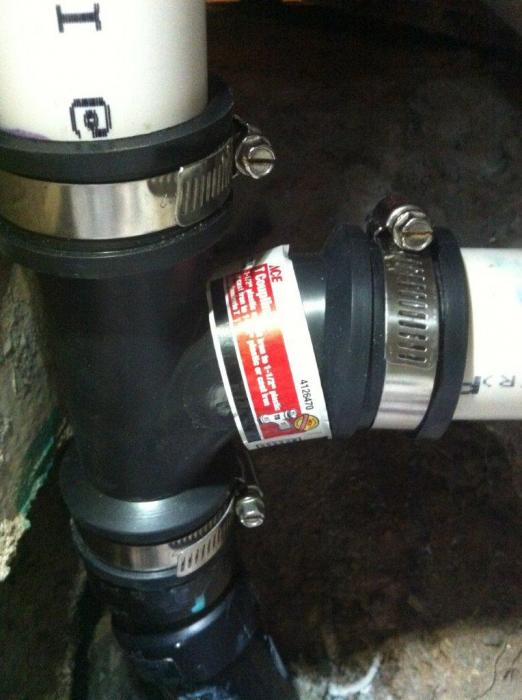

    Thanks Terry. I couldn't find a Tee version of the "shielded" coupler, only the non-shielded version. I cut out the old PVC fitting and put the new rubber T thingie in there. Seems I'm leak free for now. Do you think I'll have problems in the future because of the fittings "sagging out of position"?

    Also, why would Kohler create such a bath drain assembly out of PVC instead of ABS?
    EDIT: just saw that you edited my earlier post saying specifically that this is a BAD fitting for me to use. Hmmm. How about I pipe-clamp a few straps of steel around the sides of this thing to make it stay more straight?

    A homeowner can use a non-supported fitting like that, because a plumbing inspector hasn't looked at it.
    A coupling can be made so that it doesn't shift; the pipe is rigid inside and then you wrap it with a metal band.
    What you have is a rubber fitting without any interior or exterior support. It may be fine over time, or it could shift.
    I've seen pipes after a few years that have dramatically shifted, those were lengths of pipe that caused one side to droop down.

    You will be fine with thar repair. Don't lose any sleep over it.
    23,715
    Just remember, rubber ROTS and/or gets hard and cracks, therefore, you should make sure you can ALWAYS get to that fitting to replace it. There are several "good" ways you could have installed the drain. Using that "rubber tee" was not one of them.

    Thanks everyone. I'll keep an access panel from the room next door.
    I am curious here about what the "right" way to do this would have been. hj, you mentioned that rubber rots, but I don't know of a way to connect my PVC tub drain to the ABS drain other than with rubber (which rots) or with transition cement (which apparently is against code and not a good idea regardless). Never a better time than right now to cut the whole she-bang out and do it the "right" way.
