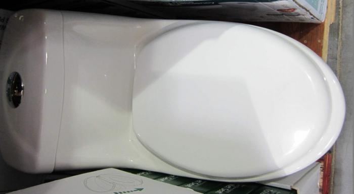

    Default New QualityCraft One Piece Dual Flush 1000G at Costco $150
    Well as of early Fall-ish 2011, Costco is now carrying a new toilet, different from the old ones. I couldn't really find much about it on the internet, so I will post everything here for the ages. Post any experience you have with it, etc. I think I will get it. It's $150 at my local Costco.

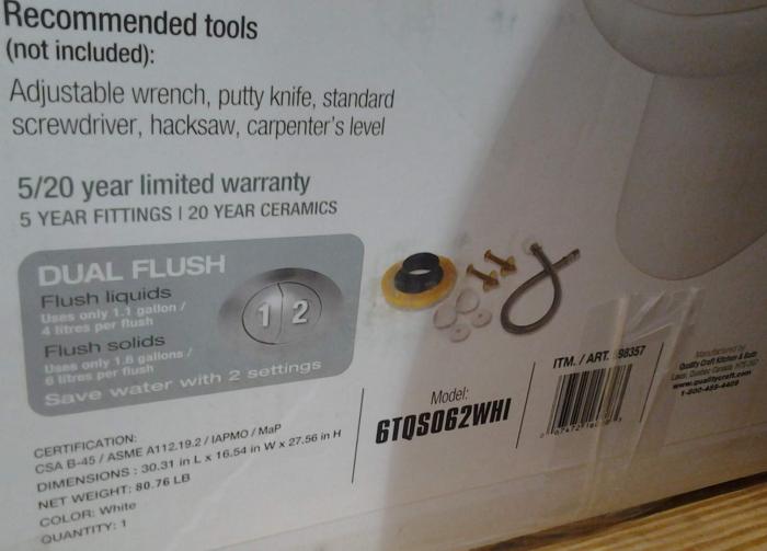

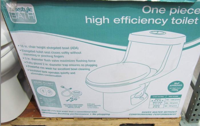

    Here are the specs:
    Dual Flush (1.1G\4 liters & 1.6 G\6 liters)
    One Piece
    1000G
    16" Height ADA
    Elongated
    Insulated
    2" Trap
    3" flush Valve
    Slow Seat
    5/20 year fittings/ceramics warranty
    Install kit.
    Model # 6TQS062WHI OR 6TQSO62WHI (O or 0?)
    Costco Model # 598357
    Nexstyle Bath

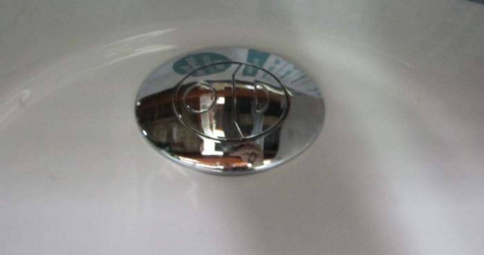

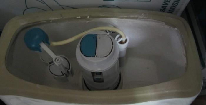

    Two observations... the refill tube appears to be set too far down the overflow tube and the 1-2 buttons are installed backwards/uʍop ǝpısdn.
    12,423
    I have one of those flush valves on my desk right now. If you can get the part, the replacement is a spin out and lift on the flush valve and that gets access for the seal.
    The customers toilet we worked on had the parts ordered up. That took a few weeks.
    These parts are not carried in hardware stores. You will have to contact Costco for parts.
