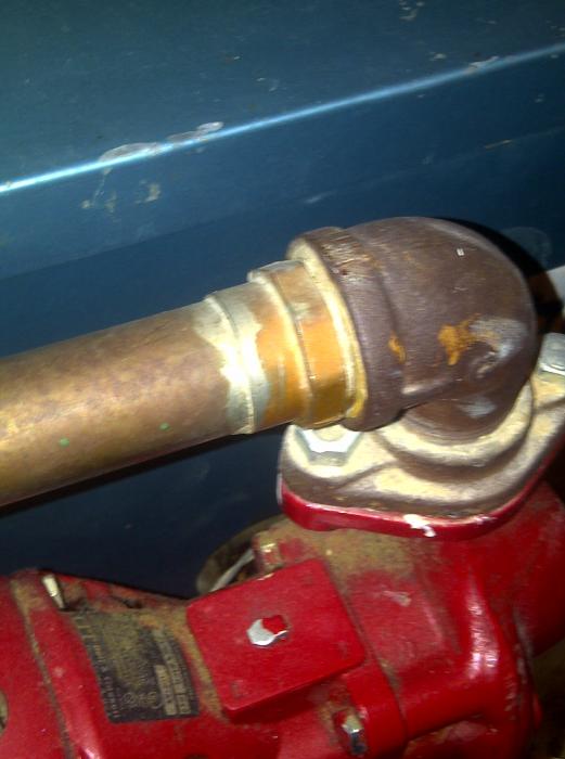

    Hey guys,
    I was called out to a house to add a zone off the boiler loop for a new bedroom. At first glance I thought I was dealing with copper. As soon as I started to shine up the "copper" so I could cut it and solder on a new fitting I noticed that the "copper" was shining up silver!
    I asked around town a bit and couldn't find anyone that has seen or heard of this type of piping before. Instead of trying to explain it in great detail I have included pictures. In one of the pictures it looks like a 1.25" Cu X Male fitting has been soldered on.
    Being heating season I don't want to cut this piping until I know exactly what it is and how I can attach new fittings on to it!
    Thank you to anyone who can help!
    Thanks,
    Rob

    Yes I have it was used during the war when copper wasn't readily available. I believe it is copper plated steel. It's a real b***h to solder it tends to burn. If you do try to solder to it use 50/50 solder I don't think that the pipe could take the heat required with today's lead free solder.
    John
    25,653
    BundyWeld was one brand of CTS steel tubing used for heating in the 50's. When new, it had tinned coating so you could solder to it, but I am not sure what your chances are after this long a time.
