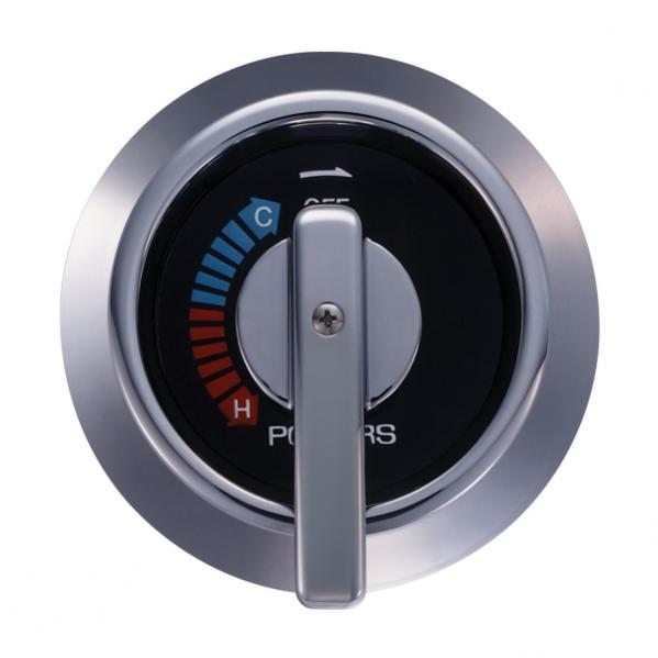

    So I've gotten 4 or 5 bids from Plumbers ranging from $600 per shower to $1250 per shower. The plumber we liked and trusted the most was of course, the most expensive. I also finally got on the phone with someone from Powers who was extremely nice and sympathetic to my cause of having a commercial shower body in my residential apartment and how that stunk for remodeling.
    Anyway, she showed me the only Powers Trim kit they offer which is this one
Size:  25.1 KBName:  100351.jpg
    I can't say it's much better than what's currently there and she agreed it's not much of an improvement aesthetically.
    My question is this, the actual lever in the second photo, there is no possible creative way to get a part from a plumbing supply that could be used in place of that they may look at least slightly nicer? It's not just a metal piece with thread and a screw?
    I am just clawing for any out of the box idea's that could possibly work to allow me not to break in the wall, change the S.b's, risk any unknowns and spend a small fortune.
    Thanks again for your expertise and feedback! Ya'll are incredibly appreciated!
  11. #26
    21,395
    There is no industry standard for trim pieces...their only requirement is that they fit their own valve body. So, anything you tried would be a crapshoot, unlikely to work, but you could get lucky. Problem is, you'd probably spend as much trying a bunch of different ones as just tearing the old one out and putting in a new one.
