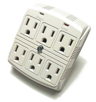

    I have added a partition wall in an existing space (next to kitchen). I will be adding one outlet extending the existing 20 amp circuit. Also, I want to have one of these outlets switched with the overhead light circuit. I am wondering if there is a problem with cutting the "hot" tab on the side of the receptacle and having the top outlet switched 15 amp, the bottom 20 amp? My concern would be if someone plugged in a surge protector (like below) or other device that gangs the upper and lower outlets. (I don't plan to do this here, but I use two such devices in other rooms.) If the two circuits are on opposite sides of the phase it could get ugly if one of these is plugged in.

    Quote Originally Posted by LHO View Post
    ... having the top outlet switched 15 amp, the bottom 20 amp?
    As I understand things, either would still only be a 15A outlet as far as its actual rating is concerned unless the outlet was specifically configured/designed/engineered for 20A (with one horizontal blade, I think) in the first place. In other words, multiple 15A outlets are typically used in 20A circuits.
    I have never seen one of those multipliers ever gang the uppers and lowers together (although that might not be true of an actual surge-protecting multiplier). In fact, I occasionally use one of them on the end of an extension cord and have never found the unused blades on the back energized. So then, the upper and lower parts of the multiplier would still act just like their places of actual connection whether or not the upper and lower were separated at the wall receptacle.

    Quote Originally Posted by leejosepho View Post
    It's not the outlet that would be 20 amp, it's the circuit and of course, the 20 amp circuit has #12 wire.
    I did get out a multiplier and a surge protector multiplier. You are right the top and bottom blades are not connected.
    Yes, and I had missed the part about your wanting to switch the other part of the receptacle with a light circuit. So, I had thought you were intentionally trying to have different amperages available at that outlet where both halves are rated at 15A. Please excuse!
    I suspect the safety engineers were way ahead of both of there since what you are doing is common, and since I am likely not the only one to ever attach a multiplier to a single-ended extension cord.
