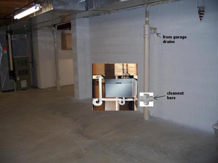

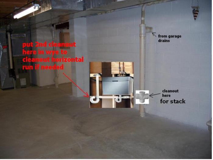

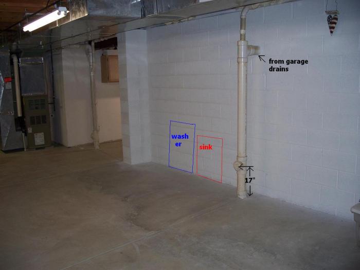

Want to install a laundry sink and washer as shown in the photo. Can I just remove the existing 4"-T from the stack, replace it with a "Double Sanitary T", use one tap of the San T as a clean-out and the other tap as the run for the sink using a wye then onto the
washer?
Also will I not need a vent for the sink/washer since it will be close to the stack?
Check out photos and let me know your comments of a better way
