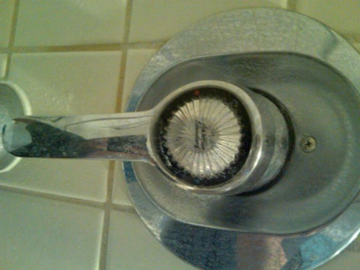

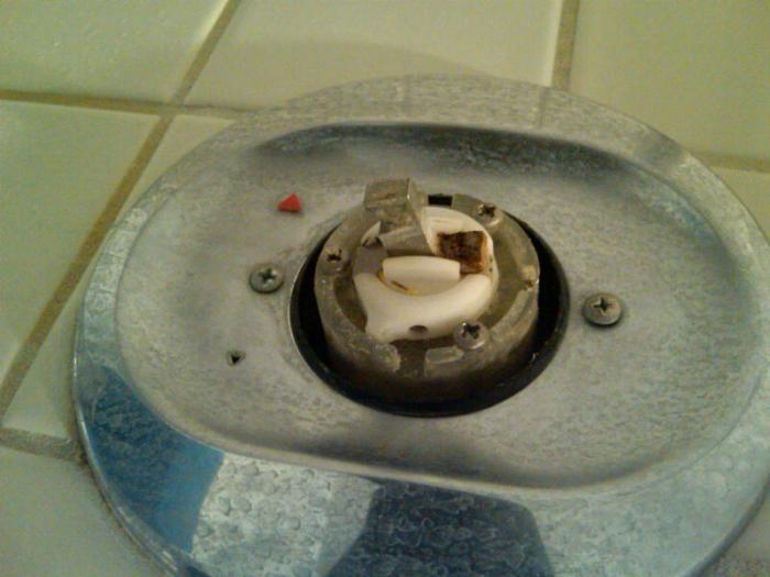

    I am having trouble finding the right cartridge and trim for this shower valve. any help would be greatly appreciated.

    I have the exact model bathroom lavatory faucet and shower valve and I bought them in the early '90's. It is called "ceramix" and the p/n for the cartridge kit from the original installation instruction is 23526.07.007. It appears that they still sell this model although it looks a lot more streamlined, but I don't know if the cartridge is the same. I don't have the instructions for the shower valve, so I can't help you with the trim. Good luck!
    9,003

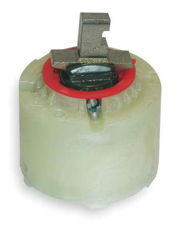

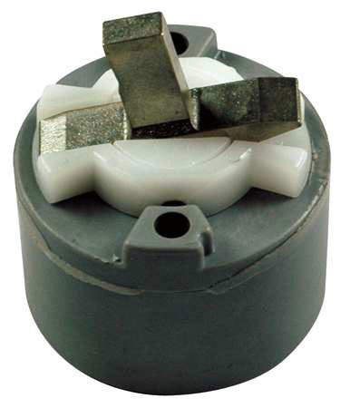

    I think the cart. number for ceramix is 023529, but that handle looks more like aquarian. Cart. for that is 057864.
    You should take the cart. into the supply house to compare/
