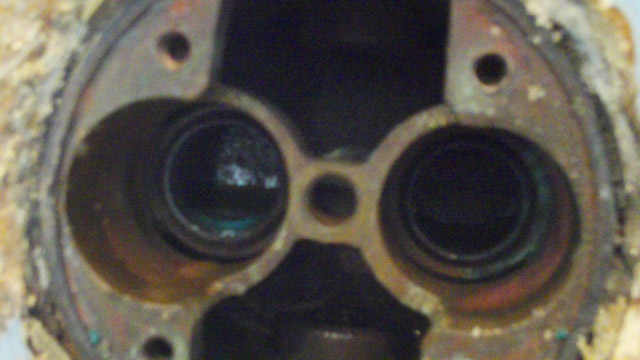

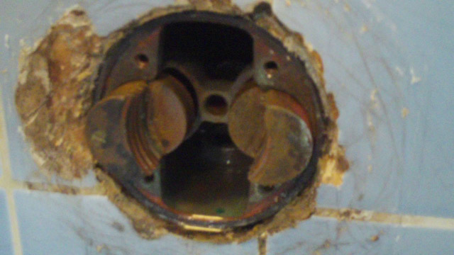

    I have what i believe is an american standard shower mixer. I think its a re -nu standard but cant find any info or pics of this despite searching on Google extensively.
    initially it was leaking as the brass screw that hold the front plate on had corroded away. Replaced them and the gaskets with neoprene but when i reassembled i have a drip from the shower. The gaskets seem to be part of the two moving slides that are in the bores on each side. one is conical the other (hot?) has a bulb on the end.
    Can anyone confirm the type of mixer and details on the gaskets. I dont want to pry them out as i will probably damage the worse than the little drip I have.
    Any help gratefully received.
    Adrian

    Your valve is model B201 or B202 with washer joint sleeves or K-100R with ground joint sleeves. With an e-mail address, I could send a parts diagram.

    anyone aware of a source for the o rings for these mixers?
    25,638
    Brown's Partsmaster (www.BPIsite.com) should be able to help, although, if you have the old ones, and they are really "O" rings, (which I doubt since I do not think there were O rings in the 20a), any good hardware store should have them. Use the part number on the breakdown I sent and you will get the correct part.

    Thanks. They weren't o rings but washers. I didn't realize the chokes unscrewed per the diagram. Thanks to you two 1920s showers are once again operational! Thanks!

    I am new to the forum and want to mention that I operate two of these old American Standard Shower valves installed in 1930. I have resealed them several times and never realized what a big deal finding new seals was. I made my own with a gasket cutter, and a drill press to turn down the washers to size.
    The valves work great and until the pitting corrosion on the shaft creates a permanent leak, they will probably outlive me. My local plumbing supply probably sees two similar units a week for parts. Many folks are so attached to their old fixtures around this area that they contract to metal spray the shafts and turn them back to size. Overkill to be sure but perhaps a sense of satisfaction is gained. Thanks for showing the pictures since the diagrams seem to be fading into obscurity.
