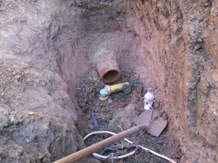

    Plumbing Contractor Will Rogers Plumbing's Avatar
    Oct 2010
    Moore, Ok
    45
Size:  71.9 KB I use a grinder. Works great for me.
