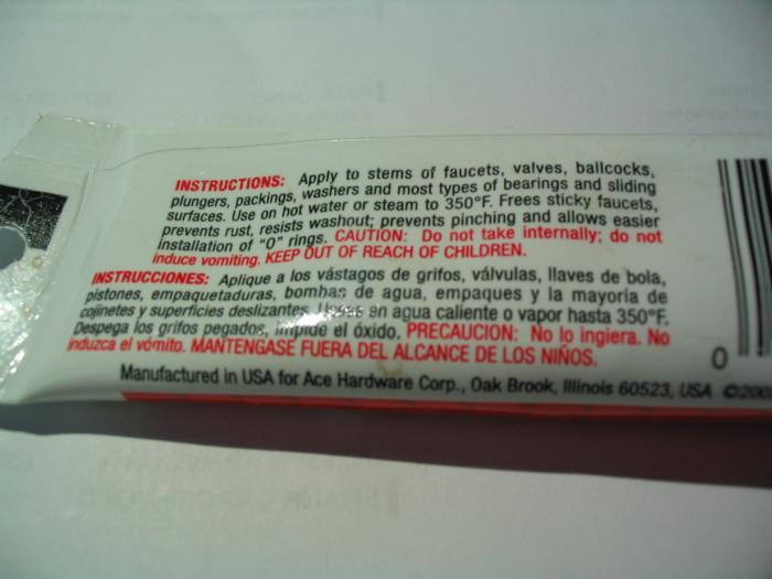

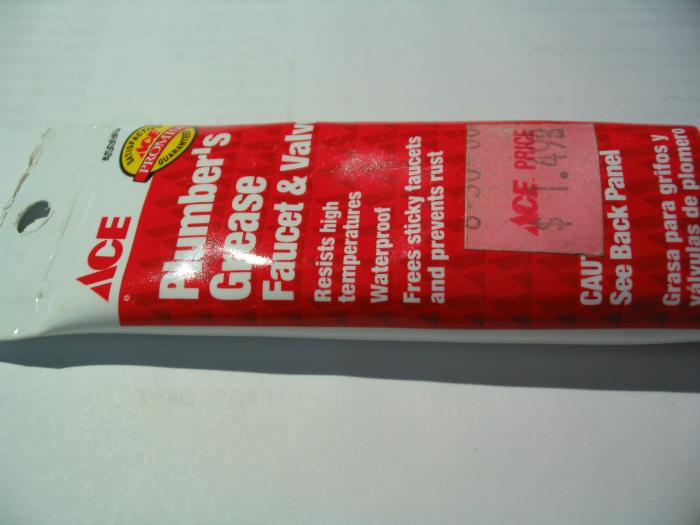

    For bobl you don't use plumbers grease on o-rings. Bad for the rubber. Silicone grease is called for, and for a one-time deal like a tub spout, soap won't hurt.
    Plumbers grease is meant for metal parts, like stem threads,cloth-impregnated packing, bonnet threads, etc. It has been widely used as a general purpose lubricant, but in the "o-ring world" it is not appropriate.

    Jimbo, I got out my tube of Plumber's grease I obught at Ace hdwe a while back at at least "it" says it is OK for O-rings. I guess there is other plumber's grease and not all O-rings are safe? anyway some pics attached here.

    Sounds like you're just getting the resistance of the o-ring and are scared to turn it further to get it on. You have other spouts if this one is damaged. Screw it on.

    Quote Originally Posted by Plumber111 View Post
    HEHEHEHEHE..... thats exactly what i was thinking! Ive installed thousands of those spouts, yes really thousands. I love them.. sometimes the first thread or 2 is actually tightening up the plastic assembly inside the spout and it seems like maybe its gonna break. But keep going. use 2 hands and turn it. It isnt a loose sloppy fit, its fairly snug so it takes a little effort to turn it. I usually turn the valve on before I set the spout up against the back wall so that i can see if the solder job and o ring are actually sealing. if they dont seal, water will spray backwards thru the hole in the tub wall and soak the area behind the wall.
    It shouldnt take a wrench, but it will take a little effort to get it threaded on. and it usually gets a little easier after a few threads
