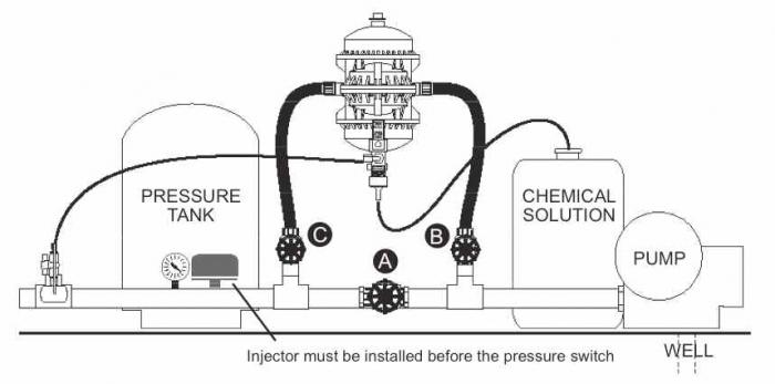

    I'm not sure if I made it clear how I'd like to install the HN55.
    This is the illustration from the Chemilizer install manual:
    (the manual is at: http://www.hydrosystemsco.com/images...n55_manual.pdf )
    Name:  chemilizer install example.jpg

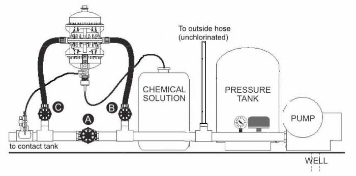

    but this is how I'd prefer to install it to have non-softened water for gardening etc. -
    Name:  chemilizer install my mods.jpg
    Is there something with this that could make the water flow backwards through the injector?
    I don't understand why they would specify installing it before the pressure switch. I haven't had a reply to emails, I might have to call them.

    Not as long as the center stop valve of the 3 way by pass is closed.
    Just a guess, but perhaps the HN55 can create a pressure drop or something and cause the house pressure to deviate from the pressure switch settings.

    I dont really see why the drawing you did would not work. The pump is a diaphragm style, it doesnt care where the pressure tank is. It is a flow based pump system, you could install a check valve after the pump to ensure water does not flow backwards through the pump head, but even that would be a non issue, the amount of water that would flow backwards should be less than a few ounces. Considering the low cost and simplicity of the pump, I would try it.

    I agree with Gary on this one. Once the residual gets out of whack, getting it corrected will be an issue and the eventual failure of the system. Ditto, I came to the same conclusion that you did. As drawn I see no reason not to go ahead with that set up and I doubt that I would bother with a check valve either although for the cost it wouldn't hurt.
