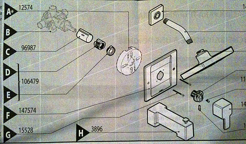

As part of a whole house remodel, we reno'd 3 bathrooms. The master shower has 2 sets of trim handles--1 for the showerhead and 1 for the jets. All in all, we have 4 sets of shower handles. They are all Moen (different models) and all have the correct rough-in valve.
Our concern is that 3 of the 4 handles look "wrong." They are not flush with the wall plate. There is a metal cylinder (part #96987) that is quite visible through the gap between the handle and the wall plate. I should add that I don't even see part #12574 anywhere in the installation the plumber did. I took it apart to check after he was gone.
Diagram of Moen Shower Trim:
http://www.moen.com/shared/docs/instruction-sheets/ins1901b.pdf

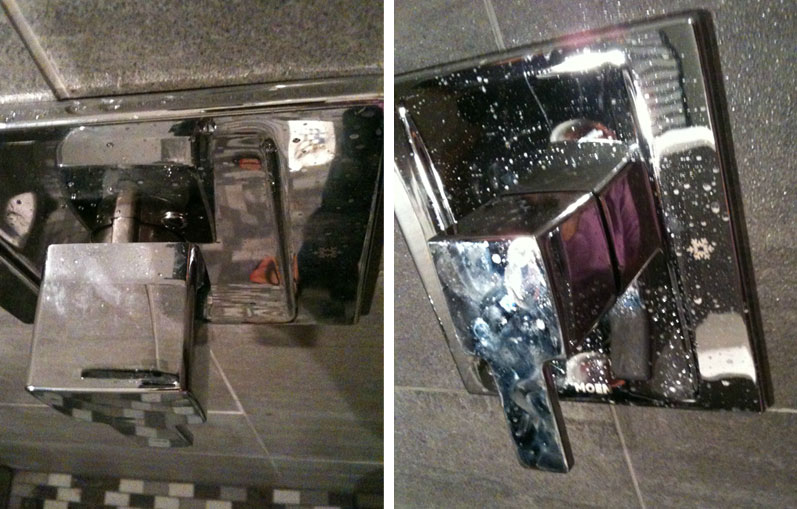

The 1 (out of 4) handle that looks correct to us:
The rest of the handles are this far away from the shower trim:
My questions:
1. Is this "normal" and acceptable?
2. If we wanted to make the handles flush with the wall plate, do we have any options as far as solutions?
BTW, we have a plumber who did the installation, and his first reaction was to think I was crazy for worrying about the gap. When I stressed the issue, he tried cutting the metal cylinder on the one that sticks out, but that had no effect on how much it sticks out. He said it's possible his partner (who did the rough in) put the valves out too far. If we were to cut a hole behind the plumbing (the tile is already in), could we "pull" the plumbing and valve further in?

The missing piece is called a "plaster guard", used to keep plaster and etc. out of the valve area while the wall is being finished. They can be and often are removed prior to tiling.
The person who roughed in the valves did not position them correctly; they should have been installed deeper into the wall. The problem with pulling the valve is that any attached rigid piping (copper, not PEX) such as supply lines or the shower riser will also need to move.

There is a min/max value for most valves and this might be as much as an inch or so of tolerance in where the valve body can be placed and the trim still fitting. This min/max relates to the installation that will allow the trim to fit, not how you might want it to look. As long as the trim fits, it is a 'correct' installation. For best cosmetic appearances, at least in the same shower, you'd want them all to be the same. If a valve is installed too deep in the wall, many manufacturers make an extension kit to move the handle shaft out so the trim can still be installed. There is no fix for the valve being too far out and showing more of the shaft (i.e., moving the handle out) except for moving the valve body back.

Please DO NOT be one of those customers who complain, "But it doesn't look like the picture or the showroom display". The ONLY time it looks like that is when it IS installed improperly, namely too deeply in the wall. IF the valve is installed close to the manufacturer's recommendation, as set by the "plaster guard" it will ALWAYS have substantial amount of the "stop tube" visible. In fact the manufacturer has a maximum/minimum variation to allow for revisions to the wall structure after the valve is installed, which WILL cause a variation in the amount of tube visible. IF the plumber tried to GUESS at what the finished wall location was REALLY going to be and erred, then he would have had to install an "extension' which would have moved the handle even FURTHER away from the trim ring. YOUR VALVE IS INSTALLED CORRECTLY IF he did not have to use an extension, and the trim plate fits against the wall. The only time it is INCORRECT is when either of those two conditions exist, meaning it is too DEEP, or too far OUT of the wall.
The "longer cylinder", and stem, is called an "extension kit", usually only used when the installation IS WRONG. A reputable plumber would NOT say the installation is wrong, so he would NOT have said anything about its positioning.

I can understand how you feel. If 2 shower valves are in the same shower (that must be a big shower stall), then I also would expect the plumber to be careful enough to make those 2 at least, mounted the same. On the otherhand, maybe there was something in the wall that interfered with the exact desired depth of mounting it? That's why I pretty much do everything myself. When I screw up, I can only blame myself and laugh at it (until my wife makes me rip it out and do it over) and realize you get what you pay for. Sad to say, contractors in just about every trade in my area are in it for a quick buck. Not everybody, that would not be fair to say, but when you find a good contractor, you stick with him. When you do a batrhroom and put good money into it, you expect more than just good function. Appearrance is very important. If the shower valves were all in different rooms, then I would be more willing to accept it. All the tradesman here say there is nothing wrong here, but I wonder if they were not plumbers and were in your situation, if they'd be willing to accept this?
Sorry to stir the pot here, but those are MY feelings.
Nowhere on the specs does it list an 1/8" variance. That would be an insane construction tolerance for a shower valve.
Even the tile grout on the wall can vary by 1/4" depending on how it's spread. And the tile itself can be either thin or thick. You would have to be God to get that one right. And then depend on God fearing men to be perfect too.
It does show on the spec sheet that the difference between the IPS and the CC (sweated) valve is 1/8" different, based on how the brass bodies are cast.
It would have been nice in the one room with two control valves if those had matched up.
Same wall or different wall?
I can say that if anyone here that plumbs had installed those valves to, and notice this (2-1/2" MAX) from center of pipe to finished wall that there would still be a goodly amount of stem showing. And that's the "Max" dimension. You can have it closer to the finished wall and it's still in spec.

You are correct about 1/8" - 1/4" being incorrect. That's what the Moen representative told me on the phone yesterday "off the top of her head." I just called back and had the rep look it up and got different numbers this time. This rep also had another suggestion.
It seems I can get an (expensive) 1/2" escutcheon extender for the handle the handles that are 3/4" and 1" away from the wall plates, and I'm happy with that solution, assuming the escutcheon extender doesn't look like crud.
My concern is still the handles in the master shower that are one on top of the other (one for shower head, one for jets) and only about a foot (if that) apart. These are the 2 in the pictures I posted in my original post. The two handles are so close together that it looks really ODD that there should be such a gap in one and almost no gap in the other.

IMHO, both are set wrong but the calculation of where the finished surface landed may or may not have been the plumber's fault. One is set too deep and the other too shallow. If I were the contractor, I would open the wall from the other side and make adjustments. Depending on how much slack there is to "pull" or "push" the rough-in, it may require re-sweating some of the joints.

I am glad your screen name says "not in the trades", because that comment would be ludicrous otherwise. A valve is ONLY set "too deep" when it needs an extension, and if it is "too shallow" you are screwed because there is no "pretty" way to make it right. Deep or shallow can also be caused by the tile installer, the construction carpenters, the builder, or the homeowner. All the plumber can do is go by what they tell him when he installs the valve, although normally since all the walls in a room should be the same, the valves should come out equal.
That "correct valve" in the second picture came within a 1/4" of being WRONG and requiring an extension, so someone was lucky. There is only one extension and it is 1" additional.

It would be typical that the handle would be out a ways from the wall.
The fact that the two valves on the same wall were plumbed at different depths was a workmanship issue.
You should not have needed to call a plumber back to make the installation plumb to the wall. Installed valves at an angle is sloppy.
Since you did call him back, he could have made them the same distance out.
You can only adjust with the adapter in the 1" increment that hj mentioned. It sucks that the plumber installed the way he did.
