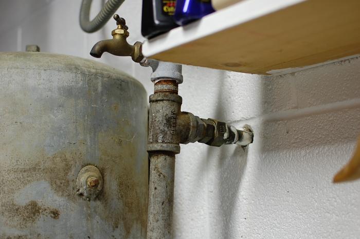

I have around an 80 gallon galvanized pressure tank (about 65 in tall).The water enters at the top of the tank.It is beggining to leak in alot of different places and i need a new one.I cant find anybody who sells them.
Somebody else recommended putting a blatter tank in to replace it.They also said i would have to pull the pump and put the check valve in the well.This well is 160 feet deep.Im realy looking for an economical way to fix this problem.Any suggetions would be great.Thanks

Excuse me, but this is confusion max. Water entering the TOP of a pressure tank?? Unheard of.
Check valve at that point without a Schrader valve? Without the Schrader or a micronizer, bleeder in the well or not, no air is entering the tank. How about a photo of this conundrum?

Water can enter the tank from the top if you choose to plumb it that way. Gravity takes over from there and if the checkvalve were to leak, it would leak air instead of water.
I was going on the assumtion that there is a snifter on or before the checkvalve. Of course it is all conjecture. Often the air volume control quits working and some folks have been known to remove the bleeder/snifter and just manually air up the tank periodically. There's no limit to frugality.

I can assure you that std. galvanized tanks have a port in the top. It takes an allen wrench to get it out, but they have ports (at least in the small to mid-size).
Most tanks have 4 ports-one low, one middle-low, one middle, and one top. 82 Gallon galv. tanks are most popular, followed by 42 gallon, followed by 120 gallon. You can still special order whatever you like, as long as you have the money they will make it.

I have plumbed water out of the top outlet, but that was for a sand-trap. the water still entered in the bottom.

Fine, but thats not a pressure tank, other wise you would get all the air first.
They use an allen fitting - BIG and TIGHT because that was their holding port for welding and painting. They dont tell you or intend you to use it for anything. Your high side port would probably do just as well in a sand trap situation.
Cheaper for a sand trap is a water heater, electric, without the heat used. I see piles of them on the road and I'll bet 80% were just leaks at the T&P or the nipples.

You're right about the top fitting being mostly for mfg. purposes. It's where it hangs when they dip it, but it can be used.
There is no high-port-only middle. Some of the older tanks as pictured have a true top-port-complete with bull plug. Don't see too many of them anymore.
