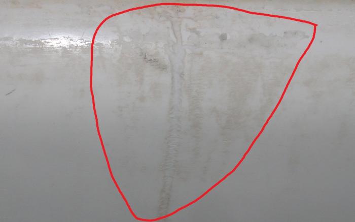

    Hi there,
    I have a good old cast iron tub. Recently I notice there is a trail of the porcelain/enamel surface eaten up -- perhaps by chemical?
    It's right below the tub shower door.
    I think that trail line goes 1/16" under the rest of the tub surface.
    Name:  Bathtub Porcelain surface 1.jpg
    The surface at the bottom of the tub is pretty rough already--probably from harsh cleaners roughing up the surface over the years.
    This trail however is quite obvious. I wonder how to repair this surface section (repair that lasts) so it's flush again w/ rest of the surface or not noticeable again.
    Or it is too eaten up to be fixed? Time to get a new bathtub?
    Thx... .
    PS: Actually, is this an enamel or porcelain surface?
    23,518
    It is a "fused" porcelain enamel. The ONLY good repair is one done by a professional refinisher, usually found in the Yellow Pages under "Plumbing fixture repairs" or "Fiberglass repair" (even though yours is cast iron". An Internet search for "Todd's fiberglass repair" in AZ MIGHT put you in touch with a similar company in your area.

    Given the understanding that refinishing isn't going to last as long as real porcelain prepared in the furnace,
    is perhaps 10 years of life expectancy for a refinished surface practically possible (assuming no harsh chemicals/abuse)? Or that's still too much to expect?

    While a refinishing job won't last as long as the original, it should be a viable alternative for you if you keep in mind a few things. One, the major portion of the cost of replacement is busting up the old tub, and replacing the tile around it, and the plumbing as well. Since the new one won't occupy the same footprint, everything will need to be re-worked. Two, it should last average of 8 - 10 years, with the possibility of as much as 20 years, depending on how often it's used, and how well it's taken care of.
    Contractors in my part of the world generally charge around $1500 for the labor alone, add to that the cost of the tub itself, tiles, plumbing, etc., and it can really add up. Compare that to a good refinishing job at around $350 to $400. I emphasize good because as has been previously mentioned, there are some substandard jobs out there. For example, if anyone says they're going to use epoxy, they don't belong in the business. Epoxy is one of the worst materials that can be used to refinish a tub. It has very poor color retention, it's very brittle, stinks for a long time, and take a long time to cure.
    If you're going to get it refinished, you need to do your homework and find someone who does a professional job. Find out what materials they use, and why. Ask if they acid etch, use a primer, and how many coats they spray, and what their warranty covers. Many companies today are cutting corners to save a few dollars. Ask if they remove the caulk and install new caulk, after they spray, not before. Ask if they need to buff out the tub after they spray - this could indicate a dry spray effect that leaves a rough finish. Make sure they come out and look at your tub and don't just quote on the phone, since you have damage. I quote many jobs on the phone, but when there's damage involved, I don't want any surprises for me or the customer. Make sure they plan on filling in the etched areas and not just spray over them. You want to make sure you get a quality job. Don't expect to pick someone off of Craigslist and a cheap price and get a good job done. Those are the guys that give my industry a bad name. Find out not just how long they've been in business, but who is going to spray your tub and how long have they been in business. The company could have a 20 year history and send out someone they just trained last week.

    In my experience....for what it is worth....ten years is pushing the envelope for the life expectancy of a refinish-in-place job, whereas the new tile job has an easy 30 year expectancy. You really want to match up that tile with a new tub.
    23,518
    A good refinish, or patch, which is what you need, will last a long, long time. It would cost more to refinish the entire tub, but it would cost LESS than the new tub, AND the wall repairs which would also be needed.
