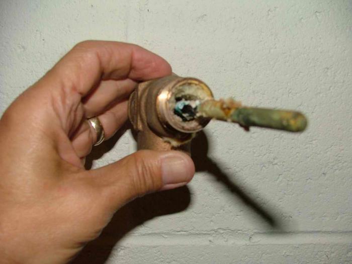

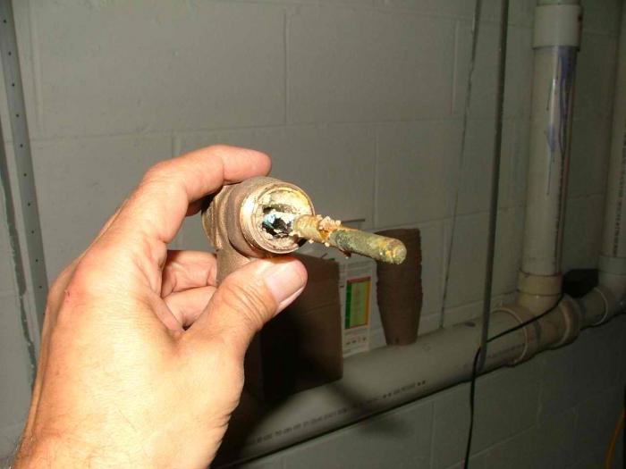

    I removed the drip pipe from the original pressure release valve and then removed the valve, itself. OH MY GOODNESS!!! Take a look!Name:  DSCF1977_2.jpg
Size:  31.8 KBName:  DSCF1978_2.jpg
    Is that scary or what?!!!
    The tank is still draining but, I don't know if I can flush all of this crap out of the tank or not. I have my shop vac jerry rigged to be a wet-dry vac I hope that I don't ruin it. I'm going to try to suck some of this out as I flush it. Oh boy!

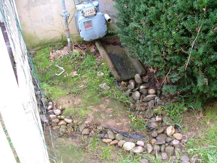

    Is there anything in "usaual" code that would prevent me from extending my exit from my sump ON THE OUTSIDE OF THE HOUSE, so that it would throw the water farther away from the house? I have a concrete tray below the exit pipe that gives an additional 2 feet or so "direction" to the exit water but, my trench, beyond that point it apparantly not sloped enough and the water is laying around the foundation more than I would like it to...see the pic
    Underneath the river rock is plastic liner material that lines the earthen troughs, directing the water away from the foundation. I am wondering if it would be allowable or appropriate to extend the exit pipe, angling it downward toward ground level. ???

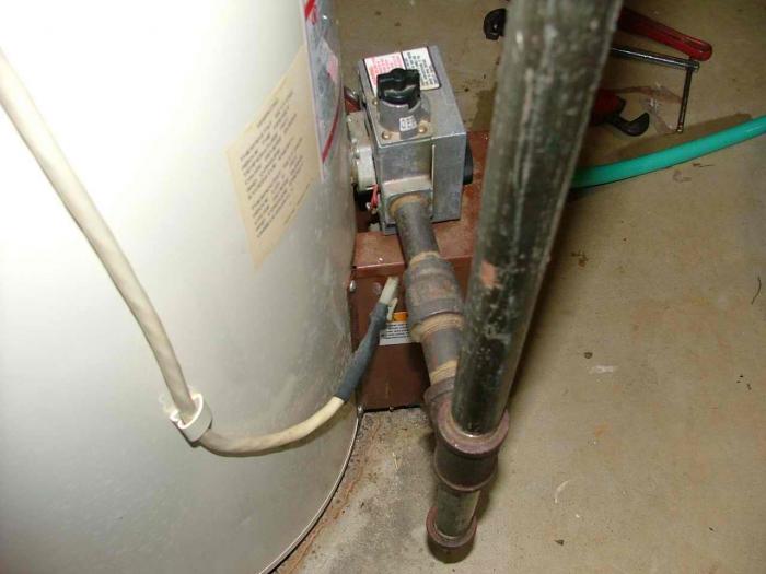

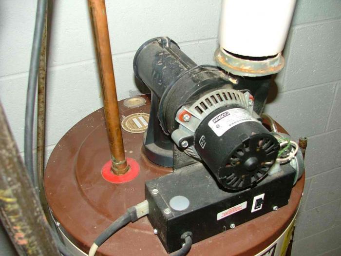

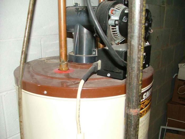

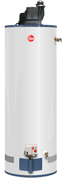

    Well, I think that I have heard enough. I think I am going to go with a Rheem 40 Gallon replacement unit. Now I have a new question. Will it be possible for me to use the existing "direct vent" set up with a new Unit? I have peeled the silicone bead that had the exhaust pipe attached to the venting unit, as you can see. Here is what the upper portion of the heater looks like...Name:  DSCF1980_2.jpg
    It looks like there may be some fabrication to do with regard to the electrical hookup from the vent motor to the thermostat unit...Are these connectors "standard" or does each brand of water heater have its own special male connectors that have to be spliced in?

    Yes you can use your exsisting vent.
    Jan 2008
    2,681
    A new direct vent water heater will come with a new blower and safety control system.
    Do not try to retrofit your old direct-vent blower to a new water heater.

    Right Cash but he can reuse the pvc pipe.

    What product pricing doesn't cause "sticker shock" today? I continued my education, online, yesterday. I realize, now that I have no other choice other than a power vent unit. Now I realize that some of my questions were generated out of ignorance. I apologize for taking a cheap shot at plumbers and their income. It takes years of apprentiship to become a good one. If someone could direct me to their choice for a 40 Gal Pwr Vnt'd Nat Gas Hot Water Heater, I want to compare my options. I found a BW MITW40S6FBN but are there less expensive models out there.

    1. NOW, you know why it is recommended that the T&P valves be tested at least yearly, and preferably every month.
